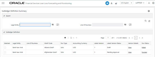

  2. In the Subledger Definition Table, select the Subledger Definition that you want to send for approval to finalize.
    Figure 26-11 The Subledger Definition Pane
    In the Subledger Definition table, select the subledger definition that you want to send for approval to finalize.

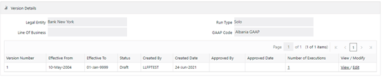

  3. In the Version Details column, click View to open the Version Details Pane.
    Figure 26-12 The Version Details Pane
    In the Version Details column, click View to open the Version Details pane

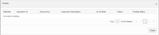

  4. In the Number of Executions column, click the link to open the Finalize Pane.
    The number in the Number of Executions Column corresponds to the number of Source Runs that you selected in the Source Run Tab of the Subledger Process Page. The Run is picked from the most recent FIC MIS Date.
    Figure 26-13 The Finalize Pane
    The number in the Number of Executions column corresponds to the number of sources runs that you selected in the Source Run Tab of the Subledger Process page. The run is picked from the most recent FIC MIS date.
