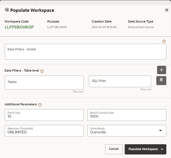

  2. Click More next to the corresponding Workspace and then select Populate Workspace to populate the Workspace with data from a dataset data in the Populate Workspace Window.
  3. Click Populate Workspace to start the process. Here, you can create the batch by using Create Batch option or create and execute by using the Create and Execute Batch option. On selecting either of these options, a workspace population task gets added to the batch.
