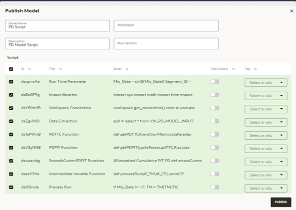

- Click
next to the corresponding Draft Model and select Publish Data Studio to open the Publish Model Window.
- Enter the details as tabulated.
Table 22-1 The Publish Model Details Form
Field or Icon Description Model Name The field displays the name of the Model. Modify the name if required. Model Description The field displays the description for the Model. Enter or modify the description if required. Technique Enter the registered technique to use. Run Version Select a run version. Script
The table displays the Paragraphs that were created in the Training Model. Select the Paragraphs that you want to use to create the Scoring Model.
Track Output - Select this to track the output of the Paragraph.
- Click Publish.
