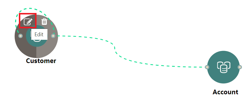

  1. On the Graph Summary page, select the graph pipeline you want to edit, click the Action icon, and select Edit.
  2. Hover over the graph pipeline and click Edit icon.
    The Node Detailspage is displayed.
