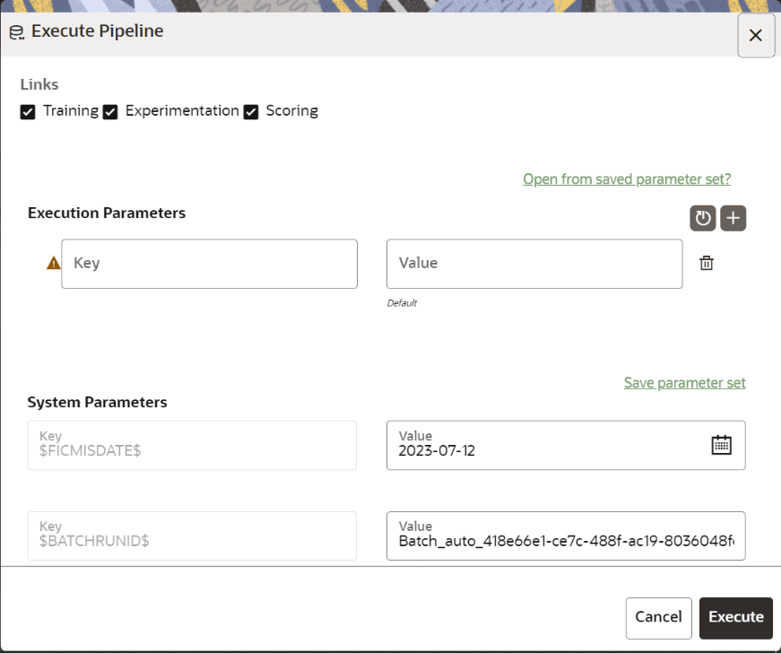

  1. Click Execute to view Execute Pipeline window.
    Figure 11-103 Execute Pipeline
    This image displays the Execute Pipeline.
  2. Execution parameters are the parameters defined in the notebook required for execution. Select the flow, which you want to execute Scoring, Training, and Experimentation. It displays all the keys defined for all the paragraphs in the notebook with a placeholder for providing the values.
  3. Enter the execution Key and Value.

    The System Parameters window also shows the execution ID, execution Date, and execution Batch. These are required for executing all the paragraphs along with other parameters. It also shows from where the parameter comes from as a subscript.

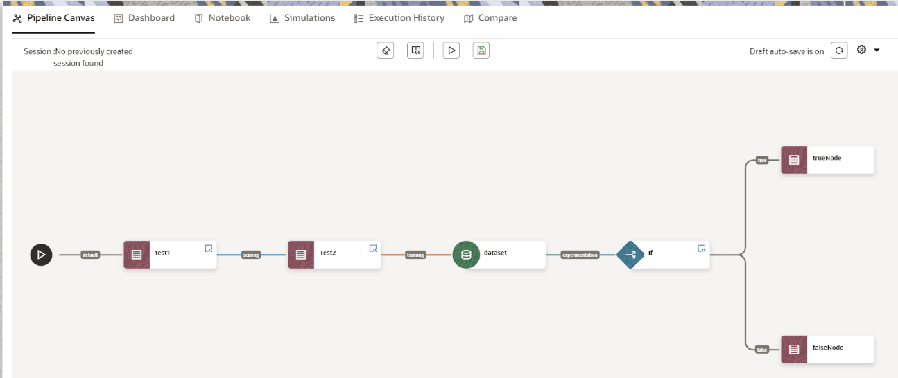

    For example, refer to below figure.
    Figure 11-104 Example of Pipeline Canvas
    This image displays an Example of Pipeline Canvas.

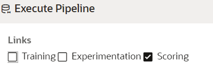

    • Here, if you want to execute this Notebook for scoring purpose, then the flow will be executed till Test 2. To perform this, Click Execute Notebook and select Links as Scoring.
      Figure 11-105 Execute Pipeline
    • Similarly, if you want to execute this Notebook for training purpose, then the flow will be executed till dataset with default paragraphs. To perform this, Click Execute Notebook and select Links as Training.
