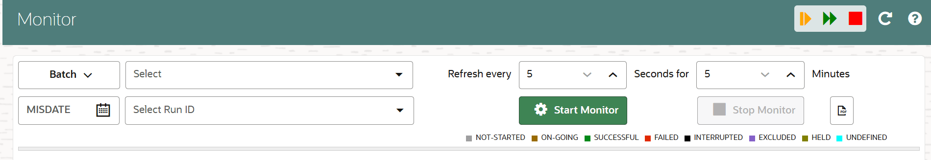

  1. Click Monitor Batch from the Header panel.
    The Monitor window is displayed.
  2. Select the batch/batch group from the Select drop-down and then select the Batch Run ID from the Run ID list.
  3. Click Start Monitor.
    The result is displayed in Visualization and List View tabs.

  4. Select Stop Monitor if you wish to stop monitoring. You can also specify the Start and Stop Monitor options along with refresh interval by providing the Refresh every seconds and minutes information.
    • You can select the refresh interval and the duration of the auto refresh. The default refresh interval is 5 seconds and default duration 5 minutes. That is, data is refreshed every 5 seconds for the next 5 minutes.
    • The interval input range must be between 5 to 60 seconds and the duration input range between 5 to 180 minutes.
    • You can use the Stop Monitor button to stop the auto refresh.

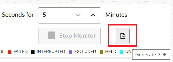

On the Batch Monitor screen, click Download PDF to generate and download a PDF report for the selected batch run.
Figure 12-5 Generate PDF Icon
Generate PDF Icon
The PDF report is also saved in the <ftpsharepath>/printservice/pdfs/scheduler/<DATE>/ path, where <ftpsharepath> is the FTP share path that was configured during the installation.
