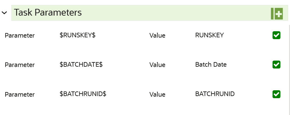

The following window shows the Task Parameters for Model Component.
Figure 11-126 Task Parameters
Task Parameters
Fields marked with * are mandatory fields.
The Scheduler Service feature provides a system-generated runtime parameter RUNSKEY, $RUNSK$, to support the delta processing of the Data Pipeline and Match Rules. RUNSKEY is generated during execution and is propagated from the batch to downstream tasks or components so they can process specific execution context. You will see $RUNSK$ listed along with other runtime parameters such as; RUNSKEY and is not user-editable. This is populated by the scheduler service at runtime.
RUNSKEY lifecycle follows the BatchRunID behavior.
  • Rerun: $RUNSK$ changes. A new RUNSKEY is generated for the rerun execution.
  • Restart: $RUNSK$ remains the same. The restart continues the same execution context.
  • Batch Date: Shows the batch execution date. You can enable or disable this parameter.
  • Batch Run ID: Shows the batch execution run ID. You can enable or disable this parameter.
