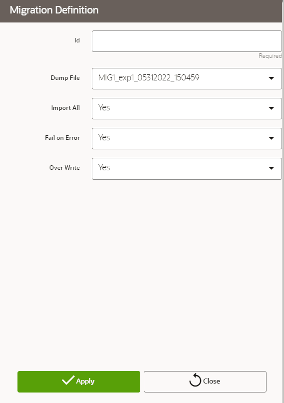

  1. Click Add in the Object Import Summarypage to display the Migration Definition window.
    Figure 14-6 Migration Definition window
    This image displays the Migration Definition window.
  2. In the Migration Definition window, enter the details for the following:
    • ID: Enter a valid name for the new migration import definition. This is a unique identifier.
    • Dump File: Select the dump file to be utilized for creating the Migration Import Definition.
  3. Import All: Select an option to import the nodes that are associated with the selected object type.
    You can edit this option if required, in the Object Selectionpage.

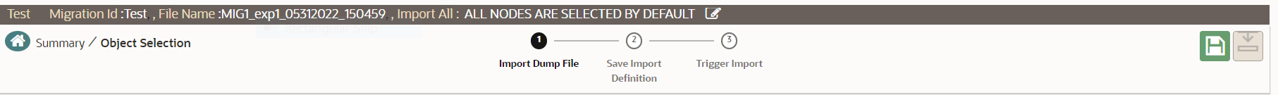

    Figure 14-7 Object Selection page
    This image displays the Object Selection page.
    • Yes - Imports all the nodes that are included in the dump file.
    • No - Imports only those nodes that you can select in the Object Selection page.
  4. Fail on Error: Select an option to proceed with the definition creation in case of an error.
    • Yes - Stops the creation process, if error is generated.
    • No - Creates the import definition even when error is generated. The node with the error is not included in the object creation.
  5. Overwrite: Select an option to overwrite the existing definition file.
    • Yes - Replaces the existing Import definition.
    • No - Creates a new Import definition.
  6. Click Apply to save the details.
