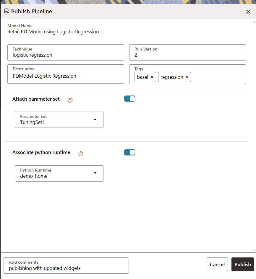

11.5.4.1.1.3.8 Publish a Pipeline
To publish the pipeline:
  1. Click Publish to view Publish Pipeline window.
    Figure 11-106 Publish Pipeline
    This image displays the Publish Pipeline.
  2. Enter the details as shown in the following table.
    Table 11-25 Field and its description for the Publish pop up window
    Field or Icon Description
    Model Name The field displays the name of the Model.
    Model Description The field displays the description for the Model. Enter or modify the description if required.
    Technique Enter the registered technique to use.
    Run Version Select a run version.
    Tags Enter one or more tags to associate with the Model Pipeline. The tags help to categorize your pipeline. These tags are permanent and cannot be modified after publishing.
    Attach Parameter set
    If this option is enabled:
    • Selected parameter set will be associated with the published model.
    • Best performing parameter set or prime reference of the objective is recommended to be associated with the model.
    • This set is further used for promoting to production at the time of deployment.
    • Users can update this dependency from model details screen.
    Associate python runtime
    • Selected python run time will be associated with the published model.
    • This python run time will be further used for promoting the model to production at the time of deployment.
  3. Click Publish.
