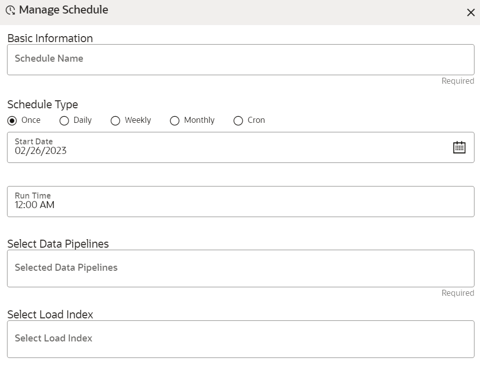

  4. Navigate to Schedule Details page and click Add Schedule.
    The Manage Schedule screen is displayed.
    Figure 11-170 Manage Schedule screen
    This image displays the Manage Schedule screen.
  5. In the Schedule Name, enter the desired name.
  6. Select the Schedule Type from the options.
    Based on the schedule type, the following input field is displayed.
    For more details and expressions of schedule type, click the help icon.
  7. Click inside the Select Task field and select the tasks. You can select multiple tasks.
  8. Click Next and add the values for the selected task, and the values are mandatory fields.

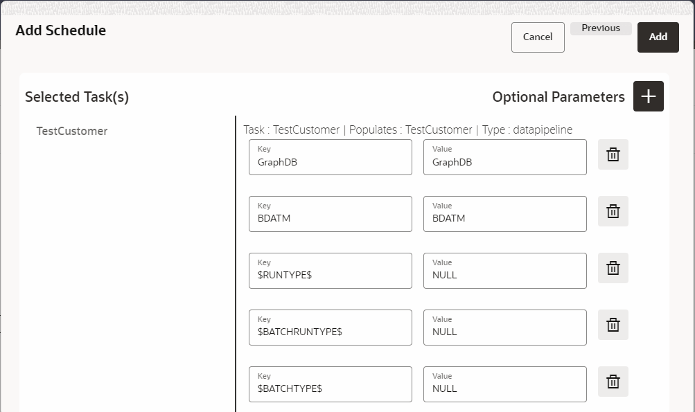

    Figure 11-171 Add Optional Parameters
    This image displays the Add Optional Parameters.
  9. Click the + icon to add optional parameters for the selected task.
    For the Pre-configured Data pipeline, respective Key fields will be displayed. You can configure the respective key-value in the Value field as required and specified in the following table:

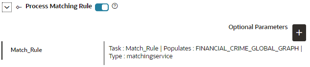

  10. To add Match Rules, enable the Process Matching Rule option and click + icon to add optional parameters.
    For more information on Match Rule, see the Creating Match Ruleset section.
    Figure 11-172 Process Matching Rule
    This image displays the Process Matching Rule.
    For the Pre-configured Match Rules, respective Key fields will be displayed. You can configure the respective key-value in the Value field as required and specified in the following table:

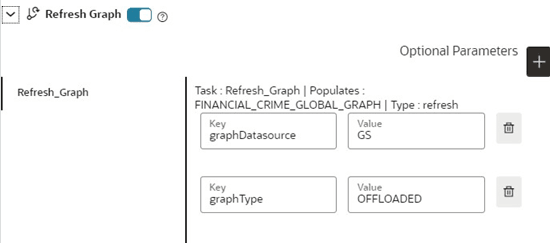

  11. Enable the Refresh Graph option and click Add to refresh the Graph to add optional parameters.
    The Key and Value parameters are not required.
    Figure 11-173 Refresh Graph
    This image displays the Refresh Graph.
    If you do not enable the Refresh Graph option, the pipeline will add nodes and edges to the Graph Schema but does not load into PGX.
