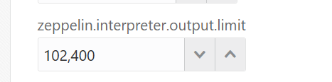

  13. What should I do when the result set is truncated if the size goes above '102400' bytes?
    Perform the following steps:
    1. Login to Compliance Studio.
    2. Navigate to interpreter zeppelin.interpreter.output.limit.
      Figure 10-2 Zeppelin Interpreter
      This image displays the Zeppelin Interpreter.
    3. Set the value to the required size.
    4. Restart the Studio Application.
