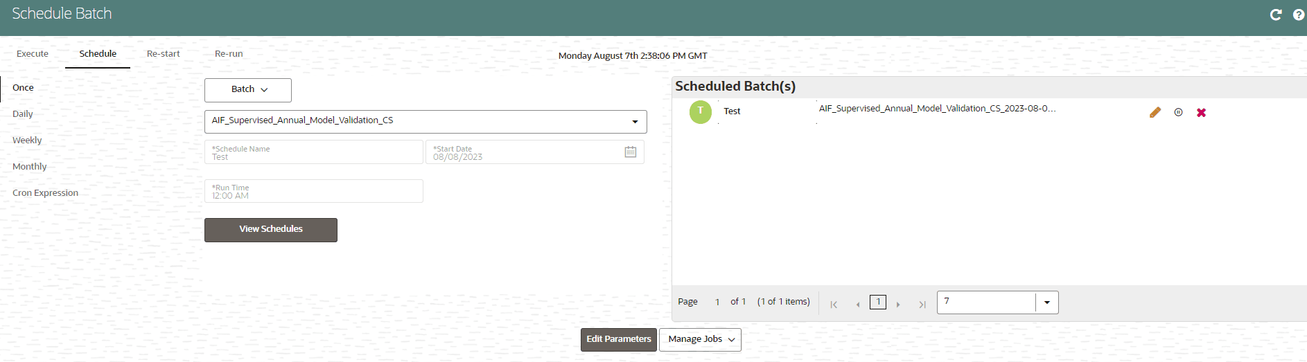

    The scheduled batches are displayed on the right pane.
    Figure 10-3 Scheduled Batches
    This image displays the Scheduled Batches.
