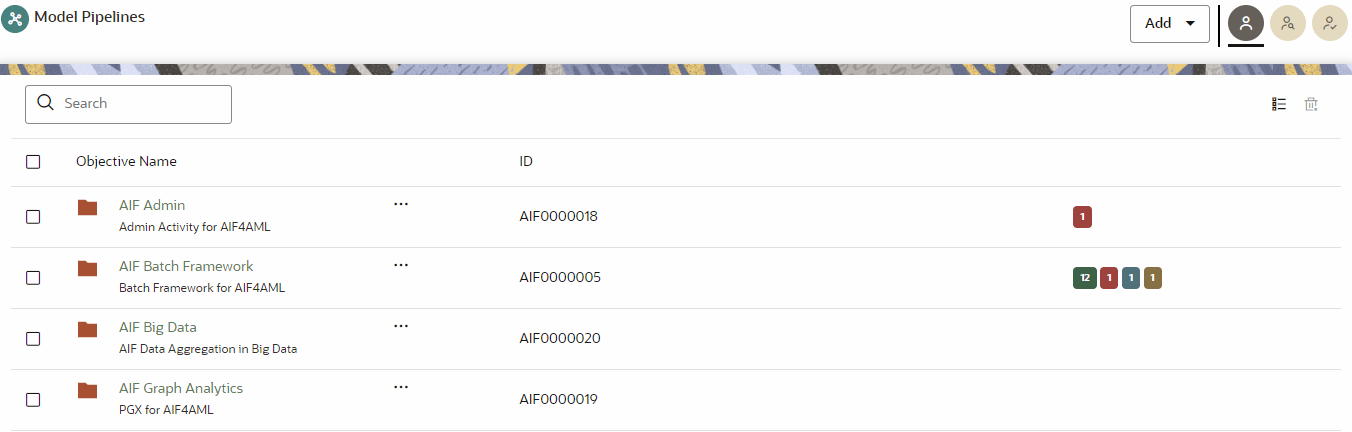

  3. In the LHS menu, click Model Pipelines to display the Model Pipelines page.
    The window displays objectives that contain drafts and models. When you hover on the count that are next to the ID column, it displays the count of sub objectives, Drafts, Models, and Champion if available.
    Figure 11-54 Model Pipelines page
    This image displays the Model Pipelines page.
    You can switch the Model Summary page view from Flat to Hierarchical and vice-versa. Flat list is the default view in Production workspace while Hierarchical list is the default in Sandboxes.
    • Hierarchical option: The Model Management window shows the hierarchical list of the Objectives using the Hierarchical option. In the Hierarchy view, you can see the following details of the Objectives such as Objective Name, and ID.

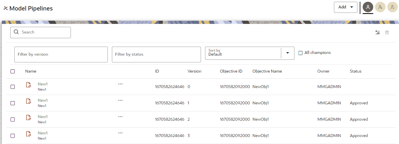

    • Flat option: The Model Pipeline window shows the flat list of all the models (published and drafts) using the Flat option. Flat list is not objective-specific. It shows the models across all the objectives. You can search the models using the Filter by Version, Filter by Status, and All champions. You can also sort the drafts and models by Default or Latest first options.
      • In the Flat list of models, you can see the following details of the models such as Name, ID, Version, Objective ID, Objective Name, Owner, and Status.
