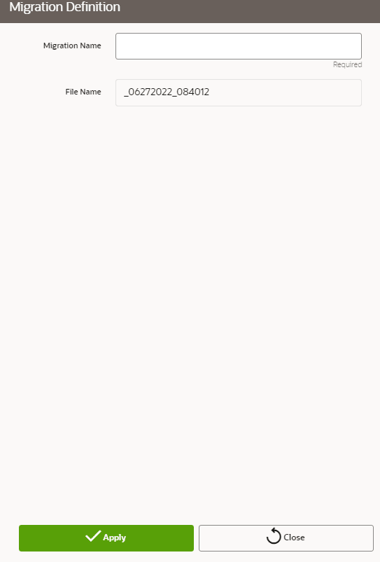

  1. Click Add in the Object Export Summary page to display the Migration Definition window.
    Figure 13-3 Migration Definition window
    This image displays the Migration Definition window.
  2. In the Migration Definition window, enter the details for the following:
    • Migration Name: Enter the code of the export of objects to be migrated definition. This is a unique identifier.
    • File Name: The system auto-creates the file name of the objects that can be used to export the definition in the following format:
      • For Business Objects: Migration Name_BO_Time Stamp (MMDDYYY HHMMSS)
      • For Identity Objects: Migration Name_IDM_Time Stamp (MMDDYYY HHMMYY)
  3. Click Apply to save the details.
