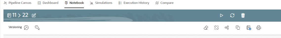

Navigate to Notebook page to view the paragraphs. You can run, invalidate session, edit, add, export the notebook, and so on.
Figure 11-77 Notebook page
This image displays the Notebook page.
