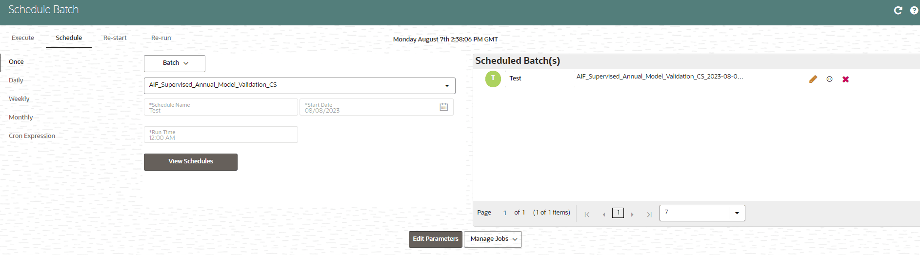

    The scheduled batches are displayed on the right pane.
    Figure 12-3 Scheduled Batches
    This image displays the Scheduled Batches.
  5. Click the pause icon for the batch you want to pause.
