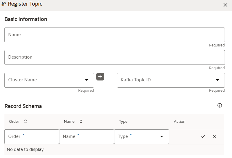

    The Register Topic page is displayed.
    Figure 9-26 Register Topic page
    This image displays the Register Topic page.
  3. Enter the Kafka Topic Name. This field is mandatory.
  4. Enter the Description for the Kafka Topic. This field is mandatory.
  5. In the Cluster Name drop-down list, select the required option and enter a unique Kafka Topic ID. This field is mandatory.
  6. In the Record Schemafield, enter the order, name, and the data type for the Kafka topic.
    Currently, PyFlink, Python, and Java Schema types are supported. For more details, click the icon next to Record Schema field.
  7. Click Register.
