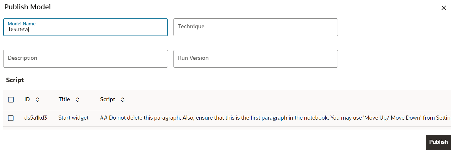

- Click next to corresponding Draft Model and select Publish Data
Studio option. The Publish Model window is displayed.
Figure 9-83 Publish Model
- Enter the details as shown in the following table.
Table 9-20 Field and its description for the Publish popup window
Field or Icon Description Model Name The field displays the name of the Model. Modify the name if required. Model Description The field displays the description for the Model. Enter or modify the description if required. Technique Enter the registered technique to use. Run Version Select a run version. Script The table displays the Paragraphs created in the Training Model. Select the Paragraphs that you want to use to create the Scoring Model.
Track Output - Select this to track the output of the paragraph.
- Click Publish.
