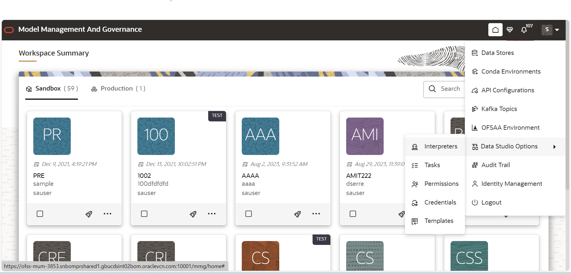

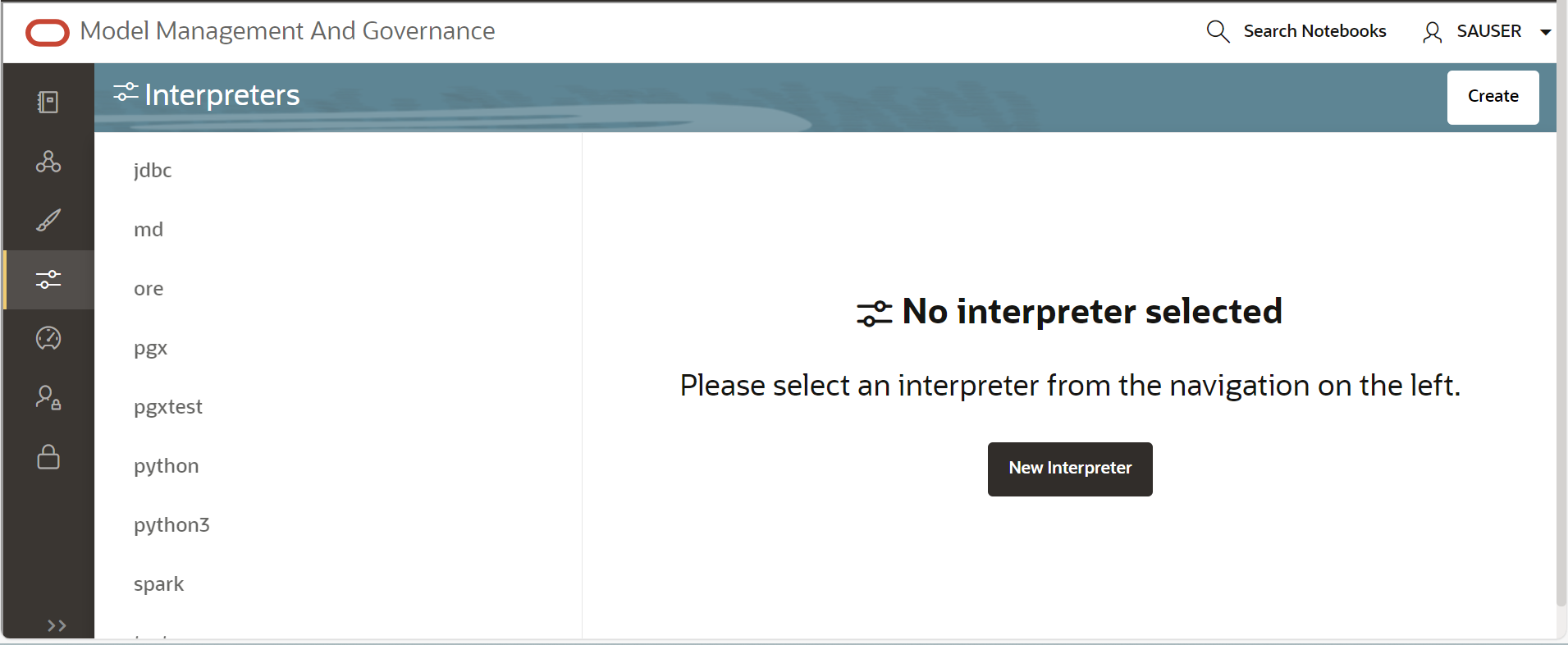

- From UI: Using Wizard screen
Go to Interpreters screen in MMG-Studio from Datastudio Options tab.
Figure 10-2 Datastudio Options tab

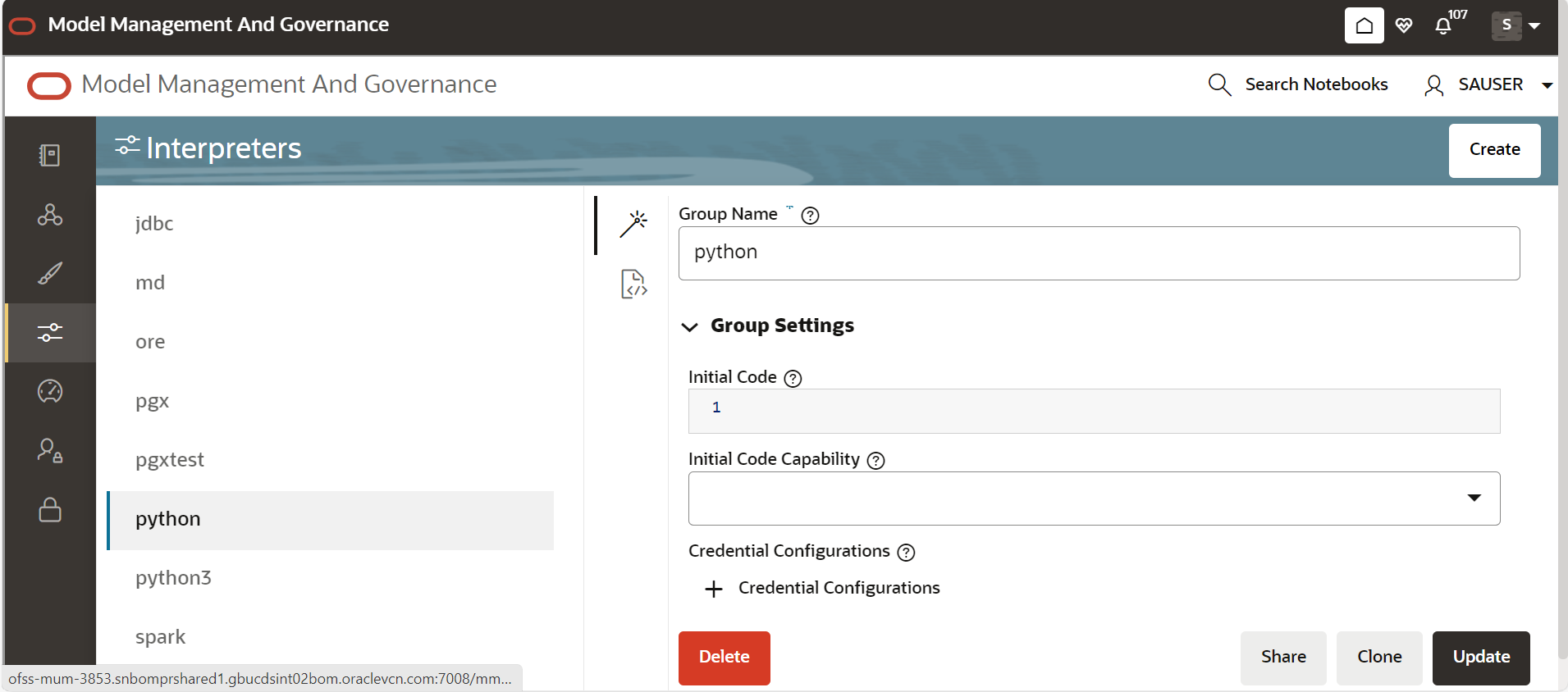

- Once on the interpreters option screen select the Python
Interpreter for which we want to configure the
zeppelin.limit.interpreter.output.
Figure 10-3 Interpreter screen
- Select python from the LHS options.
Figure 10-4 Python Interpreter

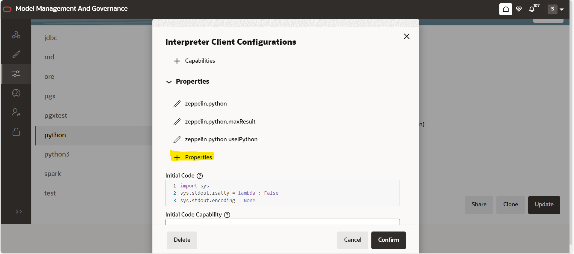

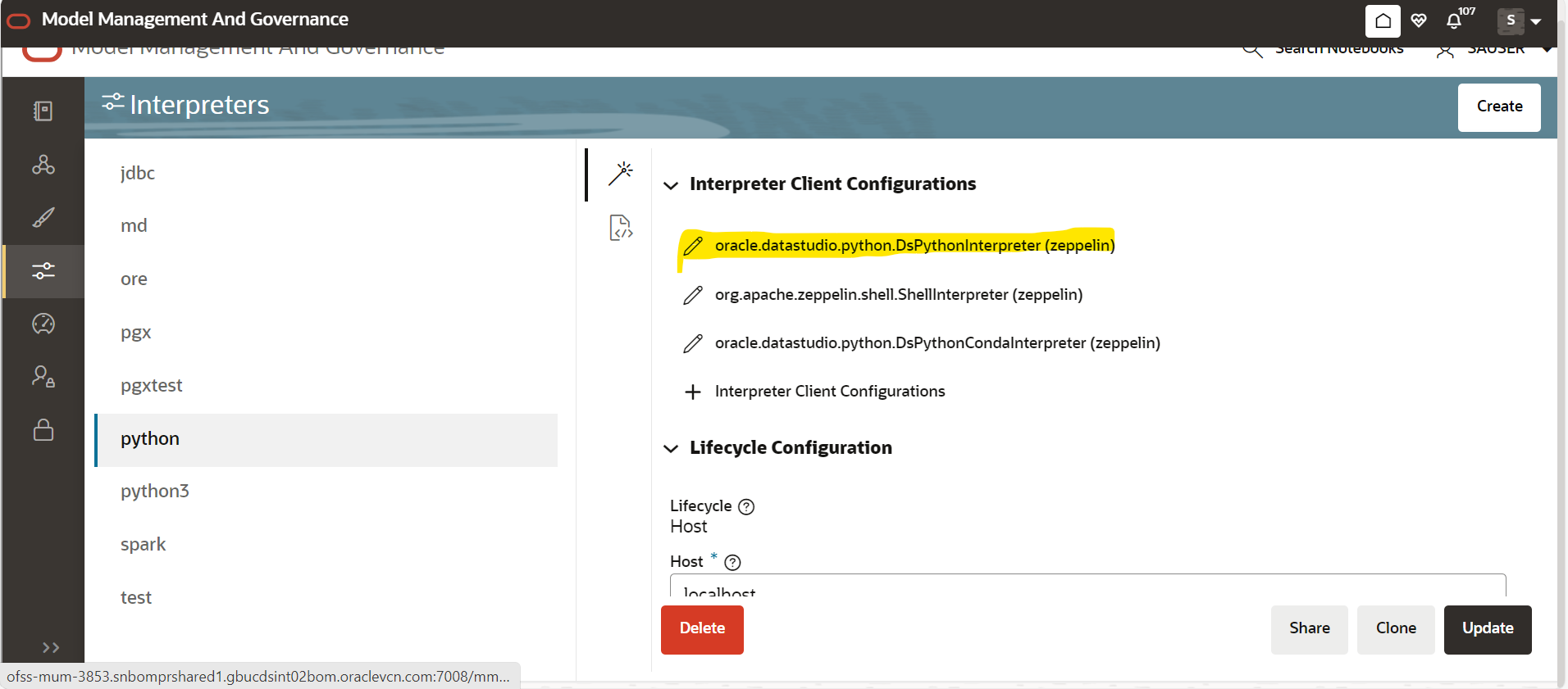

- Now scroll down in the RHS side and click on the
oracle.datastudio.python.DsPythonInterpreter under Interpreter Client
Configurations it will open a popup.
Figure 10-5 Interpreter Client Configurations
- In the popup scroll down and click on + Properties under
Properties as shown:
Figure 10-6 Properties screen

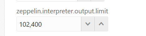

- Another popup will open fill the options as shown and set
the default value according to your needs if you are not able to see the
Create and Cancel button, click on the part of the popup pointed by red
arrow. The default value for zeppelin.interpreter.output.limit if not
set is 102400 (in bytes).
Figure 10-7 Popup box
Increasing the default option from 102400 to some bigger value will slow down the rendering of outputs of python paragraphs. - Once filled click on Create (you will see zeppelin.interpreter.output.limit under the Properties section), then click on Confirm (if you are not able to see the Confirm button on the UI, either click on the same shaded area on popup as highlighted in above image or zoom out in UI of browser) and then click on Update in the lower right side of the screen.

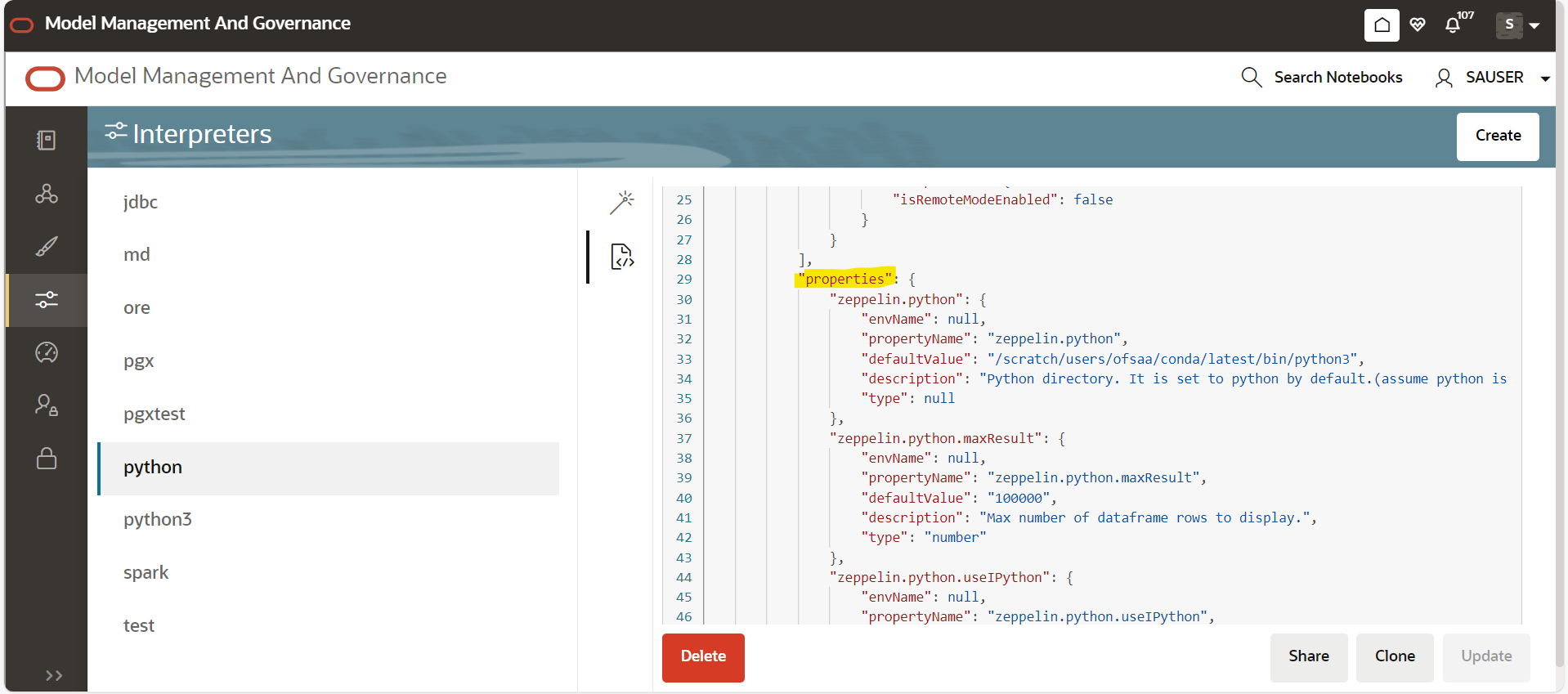

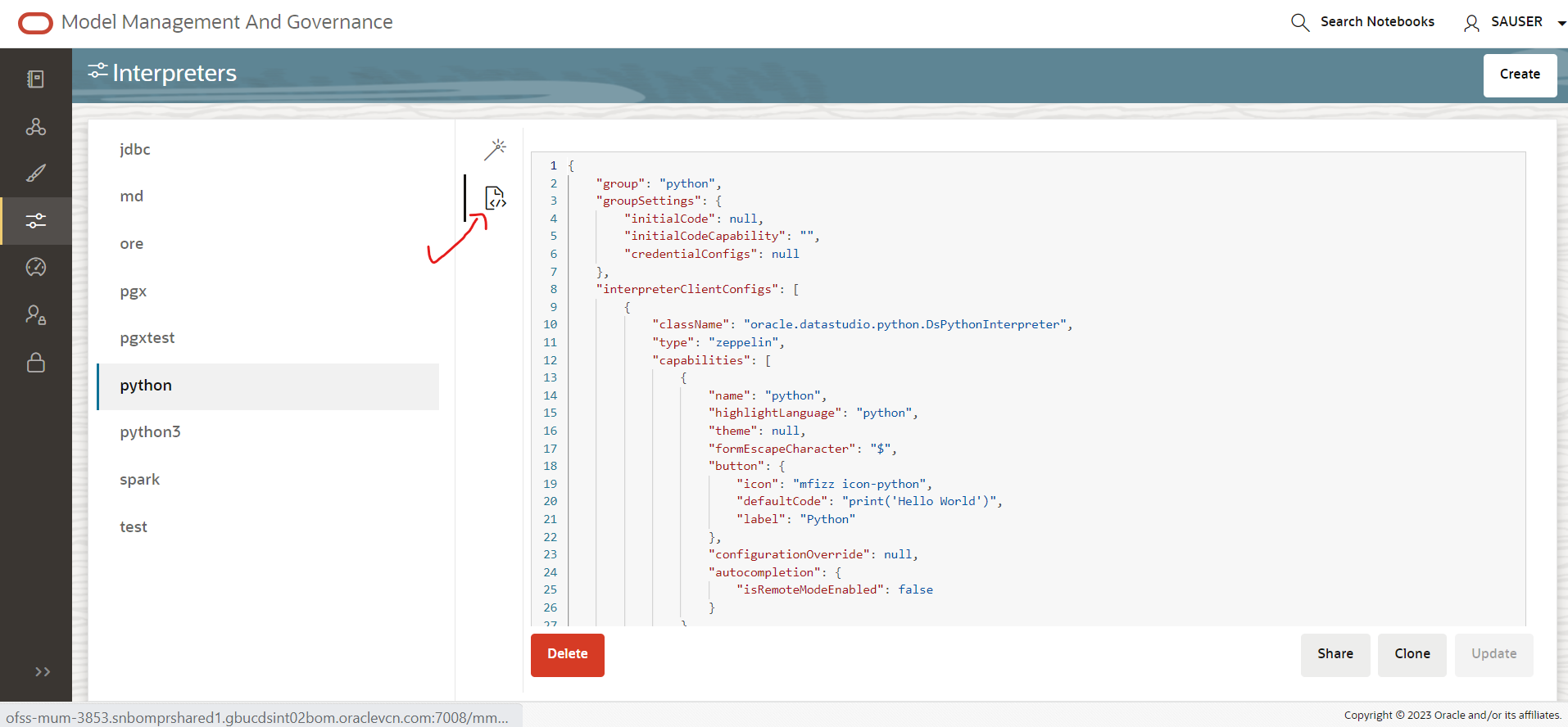

- Using JSON screen
- Follow the steps i, ii and iii from above, then click
on the following icon on UI pointed by red arrow and following
json config view will open.
Figure 10-8 JSON Config View
- Scroll down under interpreterClientConfigs with
className oracle.datastudio.python.DsPythonInterpreter you will
find following properties section with bunch of zeppelin
configurations.
Figure 10-9 Interpreter Client Config

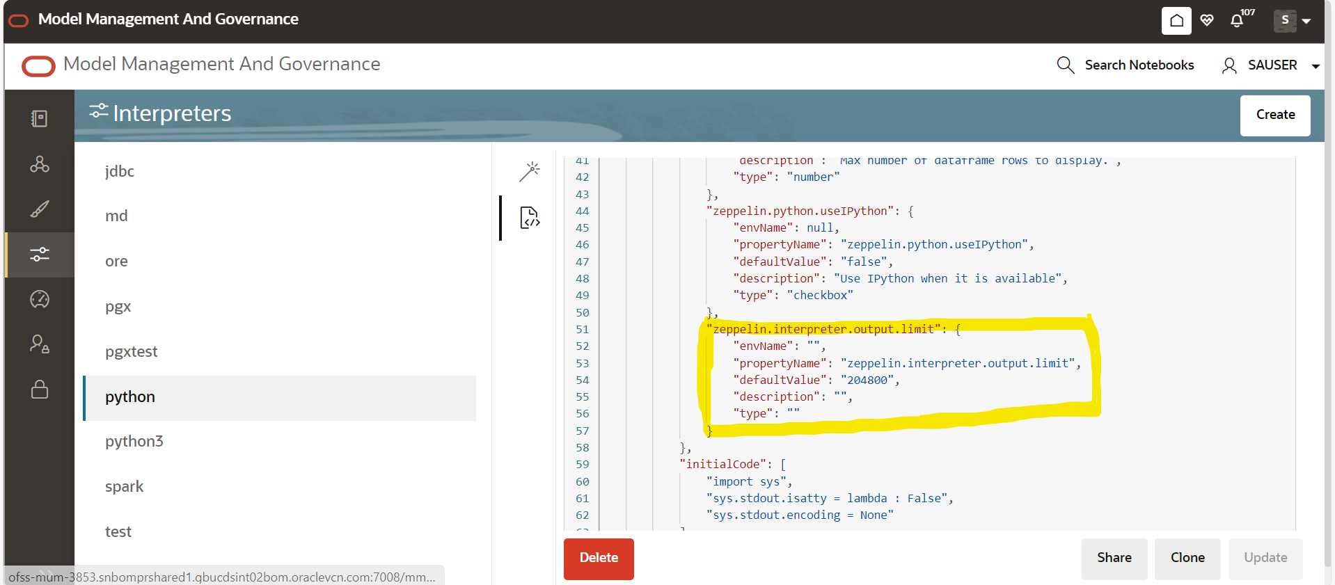

- After the last entry in properties add the
zeppelin.interpreter.output.limit also as shown in the following
image:
Figure 10-10 Properties screen
- After doing the change the Update button will get enabled in the bottom right corner click on it, you will get a message as “python interpreter updated”.

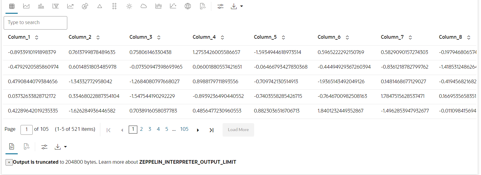

If you have configured the python environment for MMG-Studio (basically you have installed pandas and numpy which are subset of libraries required by MMG as pre-req), you can run the below script on python paragraph.%python
import pandas as pd
import numpy as np
# Create 1000 rows of random data for 20 columns
data = np.random.randn(1000, 20)
# Create column names columns = [f"Column_{i+1}" for i in range(20)]
# Create DataFrame df = pd.DataFrame(data, columns=columns)
# Display the DataFrame
z.show(df)
Output in table view
Figure 10-11 Output in table view
You can see the ZEPPELIN_INTERPRETER_OUTPUT_LIMIT value as warning if the table content is more than the set default value for zeppelin.interpreter.output.limit and accordingly you can modify the default value for same.
