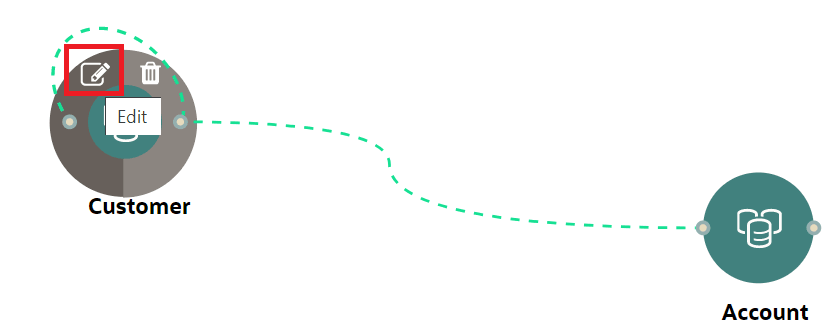

- On the Graph Summary page, select the graph pipeline you want to edit, click the Action icon, and select Edit.
- Hover over the graph pipeline and click Edit icon. The Node Detailspage is displayed.
