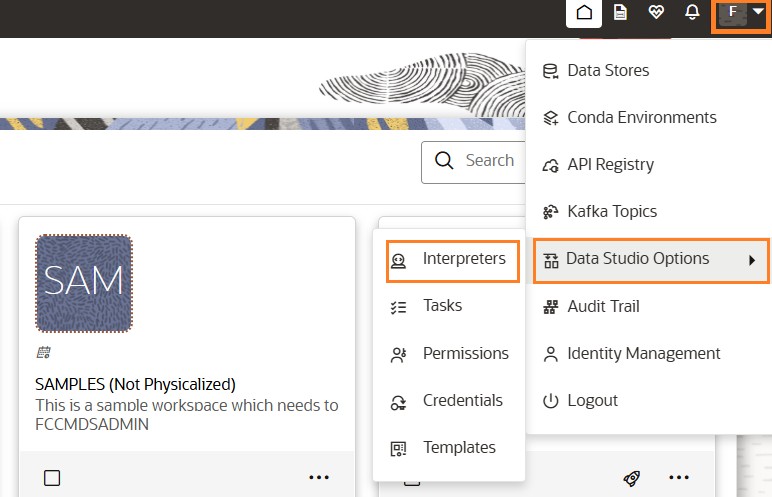

  1. Log in to OFS MMG UI.

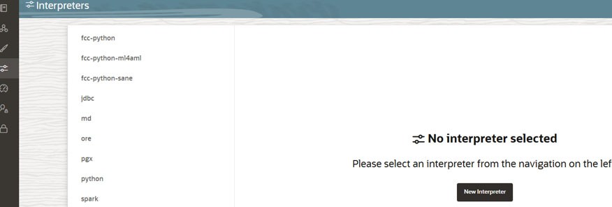

  2. Click User Profile, select Data Studio Options and then click Interpreters. The Interpreters page is displayed.

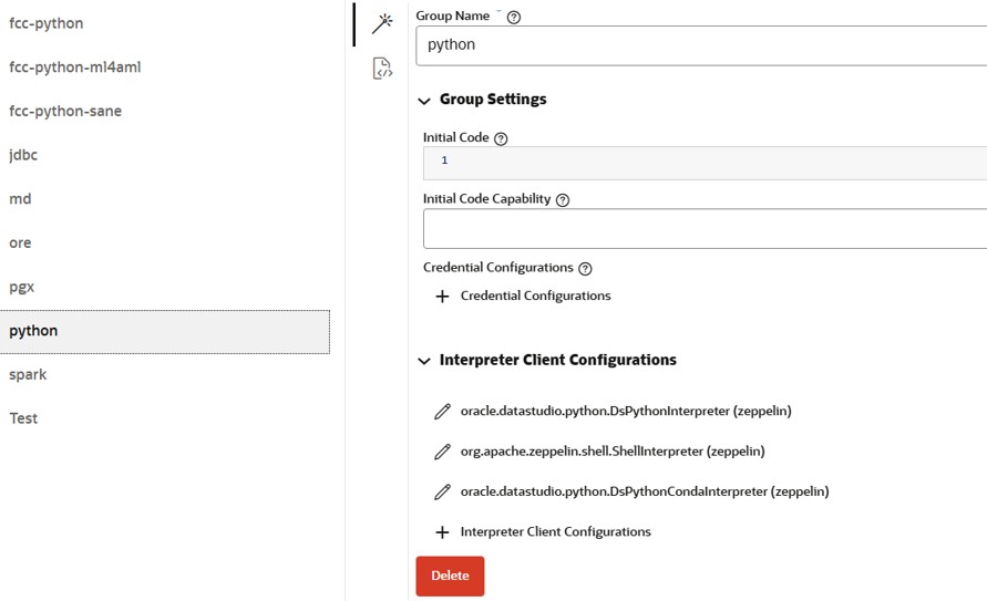

  3. On the Left-Hand Side, click python interpreter. By default, Wizard pane is displayed.
  4. On the Right-Hand Side, navigate to Interpreter Client Configurations.

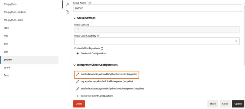

  5. Click oracle.datastudio.python.DsPythonInterpreter (zeppelin). The Interpreter Client Configurations pane is displayed.

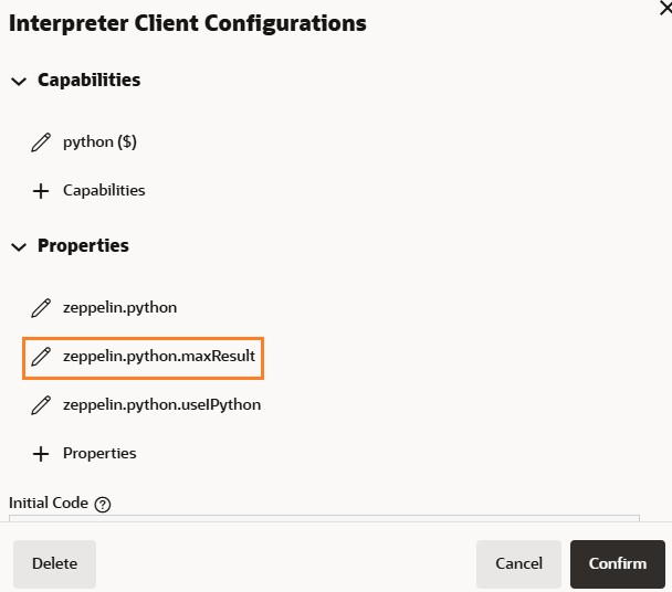

  6. Click zeppelin.python.maxResult. The Properties pane is displayed.
    Figure 8-18 Properties of zeppelin.python.maxResult
  7. Update the Default Value based on your preference. By, default the value is 1000.
