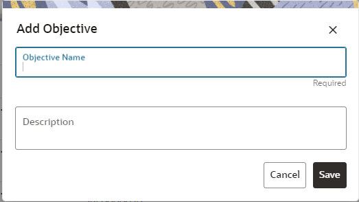

  4. Enter details in Objective Name and Description fields in the Add Objective dialog box.
    Figure 10-59 Objective Details Dialog box
    This image displays the Objective Details Dialog box.
  5. Click Save.
