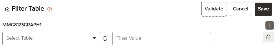

10.1.2.1.3.2 Filtering Tables
You can also use the filters in dataframe creation from entity.
  1. Click Filter Table to navigate to Filter tables window.
    Figure 10-9 Filter Table
    This image displays the Filter Table.

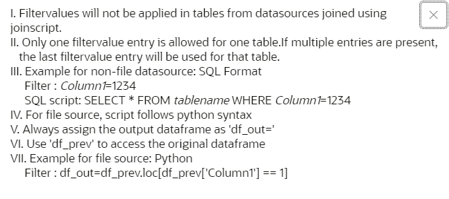

    There are certain rules to be followed when adding filters.
    Figure 10-10 Rules to be followed when adding filters
    This image displays the rules to be followed when adding filters.
  2. Multiple filters can be added by using Add.
  3. Click Validate to check the Filter conditions.
  4. Click Save.
