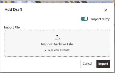

10.5.11 Import a Model Data into a New Model
The model data from existing models in .dmp format and the existing model data
in .dsnb can be imported during the creation of a new model.
The import of model data lets you reuse and extend on model
creation. This topic is part of the procedure of creating Draft Models and after
creating a new model using this method, see the Create Draft Models section for instructions on how to proceed
further.
The import should happen inside an Objective only.To import model data:
