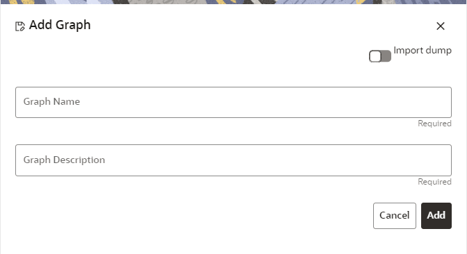

  2. Click Add.
    The Add Graphpop-up window is displayed. Figure: Add Graph window.
    Figure 11-122 Add Graph window
    This image displays the Add Graph window.
  3. In the Graph Name field, enter a name for the graph. The name must be unique to a particular workspace.
  4. In the Graph Descriptionfield, enter the description for the graph and click Add.
    OR
    You can import an existing Graph. Use the toggle button to select Import Dump.
    The following page is displayed.
    Browse the file and click Import. Once the Import is successful, the Graph Model page is displayed.
