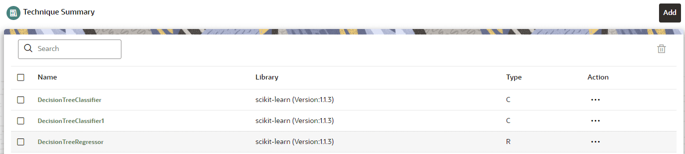

  1. In the LHS menu, click Model Catalog > Model Techniqueoption.
    The Technique Summarypage is displayed.
    Figure 11-43 Technique Summary page
    This image displays the Technique Summary page.

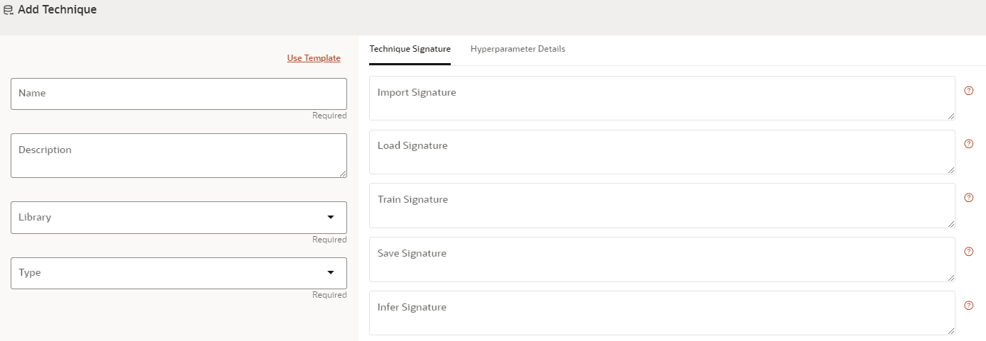

  2. In the Technique Summary page, click Add.
    The Add Technique page is displayed.
    Figure 11-44 Add Technique page
    This image displays the Add Technique page.
  3. Enter the name of the technique.
  4. Enter the description of the technique.
  5. Select the library from the drop-down. Currently, the application supports the libraries such as keras, ONNX, scikit-learn, and xgboost.
  6. Select the type as either as Classification or Regression.

  7. Enter the signatures such as Import, Load, Train, Save, and Infer. For more details on the signatures, click on the respective help icon.
