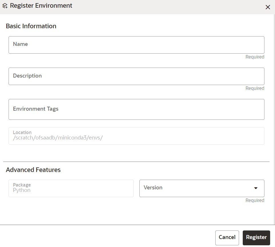

    The Register Environment page is displayed.
    Figure 8-18 Register Environment page
    This image displays the Register Environment page.
  3. Enter the Name for the environment. This field is mandatory.
  4. Enter the Description for the environment. This field is mandatory.
  5. Enter a tag in the Environment Tags field. You can add multiple tags.
    The Location of the Conda environment is displayed. This field is greyed out and cannot be modified.
  6. In the Advanced Features drop-down list, select the required python package for the Conda environment. Python as a package is selected by default.
  7. Click Register.
    The Conda environment is registered and displayed in the Environment Summary page.
