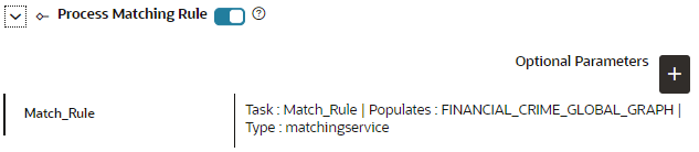

DATA $JOBNAME$ Name of the data pipeline to be executed. - To add Match Rules, enable the Process Matching Rule option and click + icon to
add optional parameters.For more information on Match Rule, see the Creating Match Ruleset section.
Figure 11-151 Process Matching Rule
For the Pre-configured Match Rules, respective Key fields will be displayed. You can configure the respective key-value in the Value field as required and specified in the following table:Table 11-28 Optional Parameter for Match Rules
Name Description Default Value datasource Oracle wallet alias of graph schema. Navigate to <OFS_COMPLIANCE_STUDIO>/wallet/ tnsnames.ora and check the Graph Schema alias name.
For example, graph_schema_alias
- loadType Execution Load Type. Available types are full and delta. In this release, only the full mode is supported.
full processingGroupName Logical processing group name for the batch. You should set it as MAN. MAN basedOnPipelineId Match rules can be executed based on pipeline Ids or ruleset Ids. The value should be true while running from the Graph.
true runSkey A numeric value indicates the runskey of the execution. 100 runType Indicates matching job that can be executed as part of graph or Entity Resolution. It should be set as Graph.

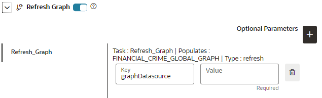

graph - Enable the Refresh Graph option and click Add
to refresh the Graph to add optional parameters.
The Key and Value parameters are not required.Figure 11-152 Refresh Graph
If you do not enable the Refresh Graph option, the pipeline will add nodes and edges to the Graph Schema but does not load into PGX.Note:
