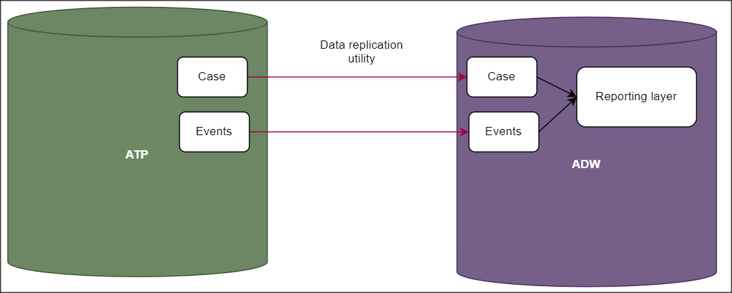

The replication utility is a tool that is used to copy data from a source schema to a target schema. It is designed to identify any changes in the source data and update the target schema accordingly. In the context of the Oracle FCCM cloud reporting solution, this utility is specifically used to update the ADW reporting schema from the ATP application schema. The replication utility is primarily developed using PL/SQL, a procedural language used for Oracle database programming.
A database link is established in ADW (Autonomous Data Warehouse) to retrieve data from ATP (Autonomous Transaction Processing). This is achieved through a job in ADW, which utilizes the system global area (SGA), program global area (PGA), and other database resources of ADW. The purpose of this setup is to minimize the processing dependency on ATP.
There are several dependencies associated with using the database link:
- ADW Wallet: The ADW instance requires a wallet that contains the necessary credentials and certificates to establish a secure connection with ATP.
- ADW Access to Object Store: ADW needs access to an object store, which is a designated location for storing files and data. This access is necessary for retrieving any required files or data during the replication process.
- Timely Refresh of Named Credentials: The named credentials used for authentication with ATP need to be refreshed periodically to ensure the security of the connection. This involves updating the fingerprint associated with the credentials.
