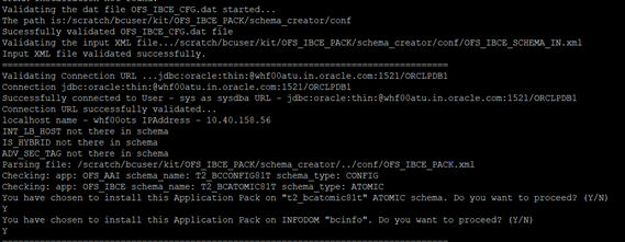

  3. The utility identifies the application packs that are already installed on the current OFSAA setup and displays the following on the console:
    • Atomic schema of the existing application pack.
    • Information Domain Name of the existing pack.
    • List of installed application packs.

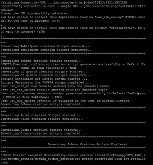

  4. Select the Atomic User on which you want to install the application pack.
    Figure 6-5 Select the Atomic User
    This illustration shows selection of the Atomic Schema and Infodom to install the subsequent Applications Pack.
    On successful execution of the Schema Creator Utility, the console displays the following status message:
    Success. Please proceed with the installation.
