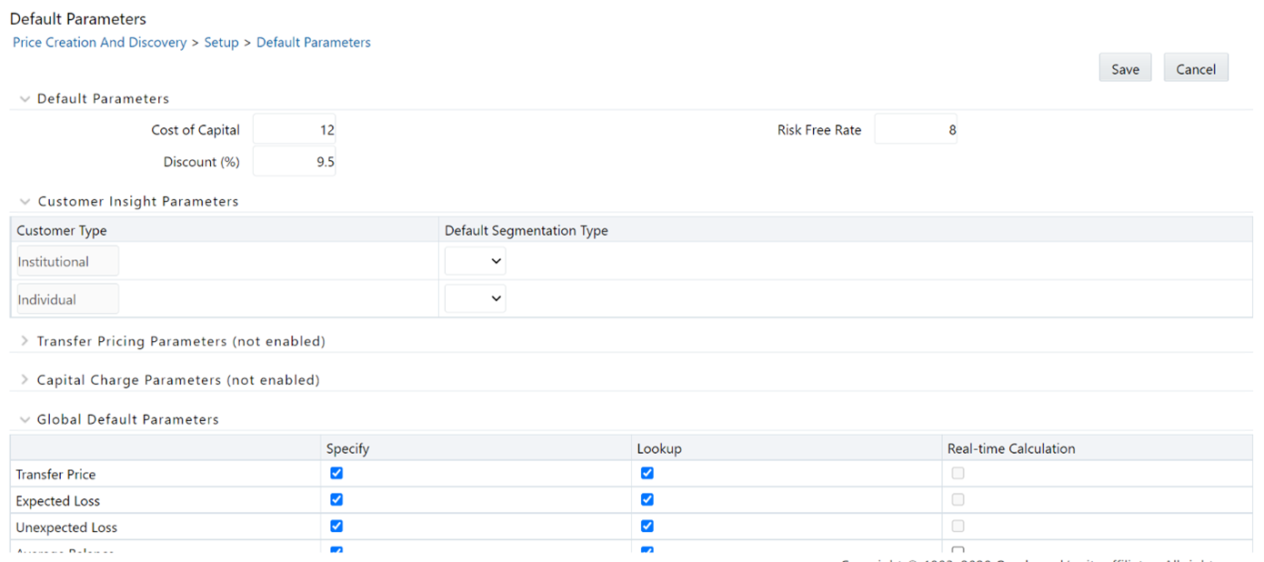

Default parameters when FTP is not enabled:Figure B-1 Default parameters when FTP is not enabled

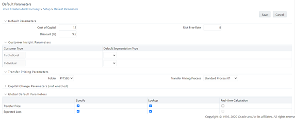

Default parameters when FTP enabled:Figure B-2 Default parameters when FTP enabled

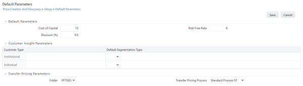

- Login to PCD Application. Navigate to the Default Parameters
and select the Standard Process under the Transfer Pricing
parameters section.
Figure B-3 Default Parameters
