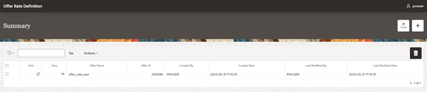

The Offer Rate Definition window enables you to manage the Offer Rate for the Pricing Definition.
To access the Offer Rate Definition screen, click Price Creation and Discovery, and then select Offer Rate Definition.
The Offer Rate Definition Summary screen is displayed.
Figure 5-20 Offer Rate Definition
