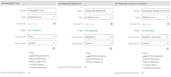

Figure 4-33 Data Action configuration in Top Down Summary canvas
From every chart available in “Top Down Summary”, except for “Net Interest Income” and “Net Interest Margin” charts, you can select a value, and then navigate to the Time, Detailed Income Statement and Defined Org Unit canvas.
In order to do so, with a right click on the chart selection, the data action option (Analyze) will appear for you to be able to pass on the data filters to the canvas that you select.

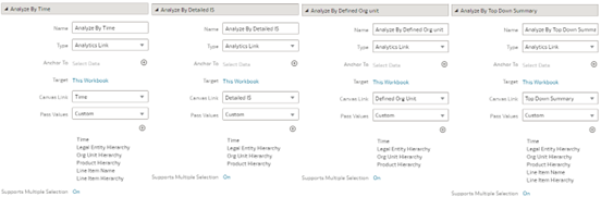

Figure 4-34 Data Action configuration in Time canvas
From every chart available in the Time canvas, you can select a value, and then navigate to the Detailed Income Statement, Defined Org Unit canvas,Top Down Summary and Detailed BS.
In order to do so, with a right-click on the chart selection, the data action option (Analyze) will appear for you to be able to pass on the data filters to the canvas that you select.

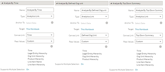

Figure 4-35 Data Action configuration in Detailed Income Statement canvas
Note that although Line Item Name and Hierarchy appear as a pass value, tool limitation currently limits passing these values to the other canvases.
In order to invoke Data Action within Detailed Income Statement report, with a right click on the reporting line selection, the data action option will appear for you to be able to navigate further to the canvas that you select.

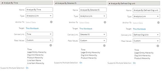

Figure 4-36 Data Action configuration in Defined Org Unit canvas
From every chart available in the Defined Org Unit canvas, you can select a value, and then navigate to the Time, Detailed Income Statement or Top Down Summary canvas.
In order to do so, with a right click on the chart selection, the data action option will appear for you to be able to navigate to the canvas you selected.

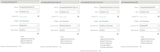

Figure 4-37 Data Action configuration in Detailed BS
From every chart available in the Detailed BS canvas, you can select a value, and then navigate to the Time, Detailed Income Statement Defined Org Unit, or Top Down Summary canvas.
In order to do so, with a right-click on the chart selection, the data action option will appear for you to be able to navigate to the canvas you selected.
