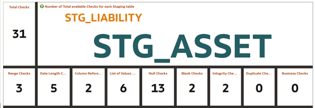

Total Checks: Number of Checks created in the OFSAA Application.
Number of Total available checks for each Staging table: Gives the information regarding number of checks based on the various staging tables.
The following reports gives the information regarding the number of various checks created.
- Range Checks: Total number of Range checks defined in the system.
- Data Length Checks: Total number of Data Length checks defined in the system.
- Column Reference Checks: Total number of Column Reference checks defined in the system.
- List of Values Checks: Total number of List of values check defined in the system.
- Null Checks: Total number of Null checks defined in the system.
- Blank Checks: Total number of Blank checks defined in the system.
- Integrity Checks: Total number of Integrity checks defined in the system.
- Duplicate Checks: Total number of Duplicate checks defined in the system.
- Business Checks: Total number of Business checks defined in the system.

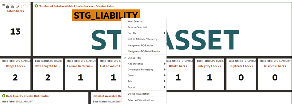

Figure 5-11 Number of Total available Checks for each Staging table
Data Quality Checks Distribution gives the distribution of checks based on the base tables.
Figure 5-12 Detail Quality Checks Distribution and Detail of Available Quality Checks in the Platform

Data Action: A Data Action link can pass context values as parameters to other canvas. In Data Quality Reports we have two data actions namely DQ Results and DQ details results.
DQ Results: When user right clicks on any element and navigates to DQ Result, the selected object will get passed as a filter and pass this filter in DQ results Canvas.
DQ Result Details: When user right clicks on any element and navigates to DQ Result Details, the selected object will get passed as a filter and pass this filter in DQ Results Details Canvas.
