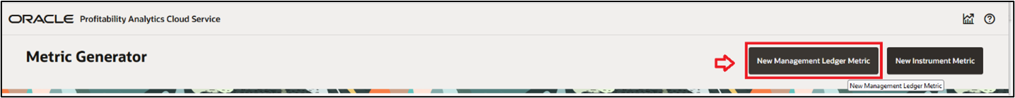

To create a new Management Ledger Metric:
- Click Add New Management Ledger Metric on the Summary screen.

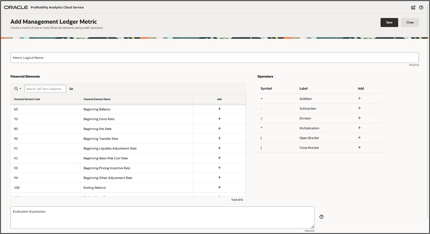

This will take you to the next screen to define the custom metric and input the evaluation expression.Figure 6-31 Add Management Ledger Metric
- Enter the Metric Logical Name of the custom metric as it will appear in the reports.

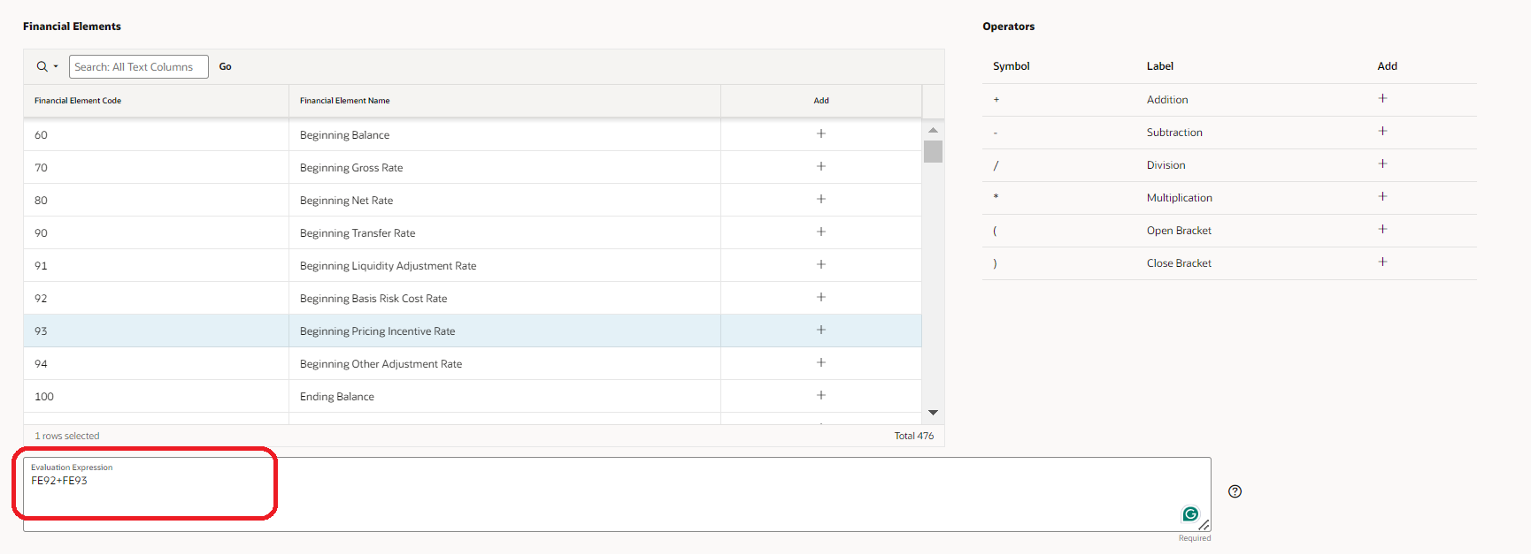

- Select any one of the following details:
- Financial Element Code
- Financial Element Name
- Operator
Figure 6-32 Financial Elements, Operators, and Evaluation Expression

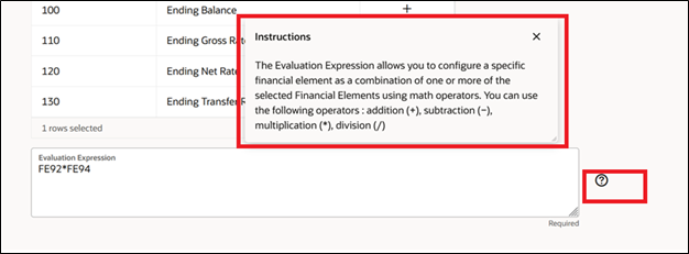

Evaluation Expression is the box where you create the calculation using Financial Elements and mathematical operators.
You can refer to the Help button support with the Instructions on how to configure the metric.Figure 6-33 Evaluation Expression Help button
