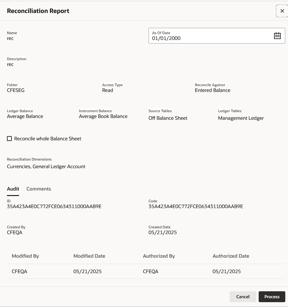

  • Execute: Click this action button and perform the reconciliation as per the selected parameters.
    As-of-Date is a run time parameter, you can choose for which date reconciliation needs to be performed.
    Figure 5-6 Reconciliation Report
    If the Reconcile Whole Balance Sheet checkbox is selected, the system retrieves all available dimension combinations from both the FSI_D_MGT_LEDGER and the selected instrument tables, regardless of whether matching dimension combinations exist between the ledger and the instrument tables.
    After clicking Process, the Reconciliation Difference Report will be generated as follows:

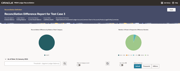

    Report starts with the summary across Balance Sheet categories and difference buckets pie charts, which can help you to get an idea about the reconciliation difference in a quick glimpse.
    Figure 5-7 Reconciliation Difference Report
    The detailed report is displayed as follows, where you can filter out insignificant difference using ‘Threshold Percentage’, also threshold can be applied at each row level or for whole Balance Sheet category level. If threshold is applied at Balance Sheet category level, all the rows that belong to the Balance Sheet category which is less than given percentage will be hidden from the Reconciliation Difference Report. A download button allows you to download the Reconciliation Report.
    You can select Filter at Category Level toggle switch to apply threshold at ‘consolidated difference reports’, which is at balance sheet category level OR can directly apply the threshold to each difference row, which is available at the unique combination of selected key dimensions.
    You can select the ID / Code toggle switch to see the CD data. By default, the toggle switch displays the ID data.
    You can also change the unit of balance to thousands or millions.
    You can see difference in both percentage and absolute format.
