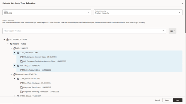

To create a new Product-Currency combination and default attributes for that. You can click the Add button, and a slide in pop-up will appear with three tabs:
Figure 5-16 Default Attribute Tree Selection
After select the product, click Save. The Default Attribute Details window is displayed.
System auto-populates the default attributes for product-currency combination in Default Attribute Details window. You can edit them as required.

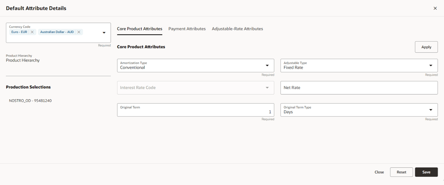

Core Product Attributes Tab: Here you can select one or multiple products and one or multiple currencies and start defining core product attributes as follows:
  • Amortization Type
  • Adjustable Type
  • Interest Rate Code
  • Net Interest Rate
  • Original Term
  • Original Term Type
Figure 5-17 Core Product Attributes
In the Core Product Attributes tab, you can select one or multiple products and one or multiple currencies and start defining core product attributes.
Click Save and move to the Payment Attributes tab.

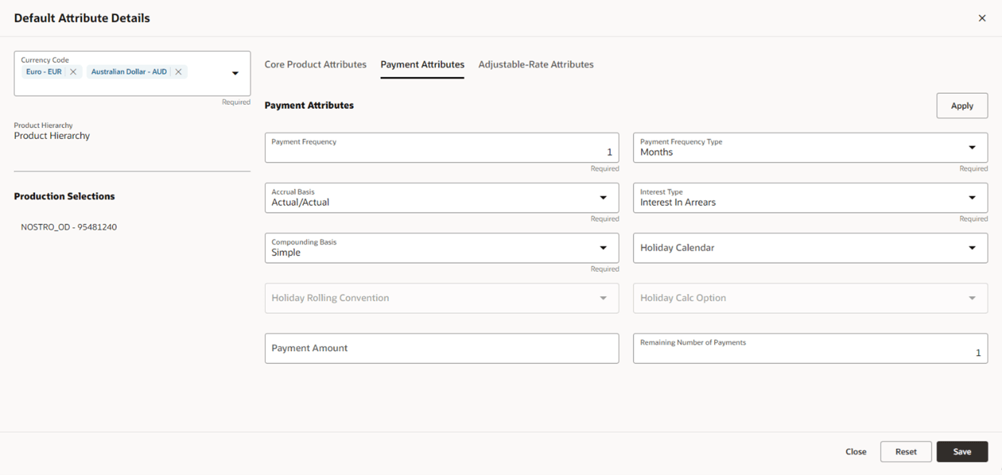

Payment Attributes Tab: To Define payment attributes, you can select this tab and start filling the following details:
  • Payment Frequency
  • Payment Frequency Type
  • Accrual Basis
  • Interest Type
  • Compounding Basis
  • Payment Amount
  • Remaining Number of Payments
Figure 5-18 Payment Attributes
In the Payment Attributes tab, you can select one or multiple products and one or multiple currencies and start defining payment attributes.

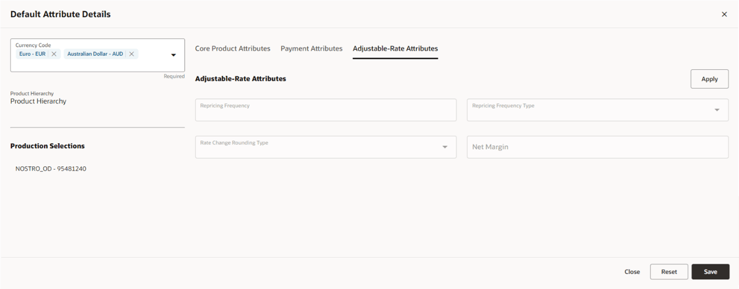

Click Save and move to the Adjustable-Rate Attributes tab, which is applicable only for adjustable rate instruments:
Adjustable-Rate Attributes Tab: Here you can define following attributes:
  • Repricing Frequency
  • Repricing Frequency Type
  • Rate Change Rounding Type
  • Net Margin
Click Save and then click Save. The Default Product Attribute for the selected Product-Currency combination is saved.
Figure 5-19 Adjustable-Rate Attributes
In the Adjustable-Rate Attributes tab, you can define the Repricing Frequency, Repricing Frequency Type, Rate Change Rounding Type, and Net Margin.
