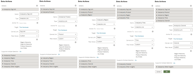

Figure 9-86 Data Action Configuration in Org Unit canvas
From every chart available in Org Unit you can select a value, and then navigate to the Product, Region and Other Insights canvas.
To do so, with a right click on the chart selection, the data action option (Analyze) will appear for you to be able to pass on the data filters to the canvas that you select.

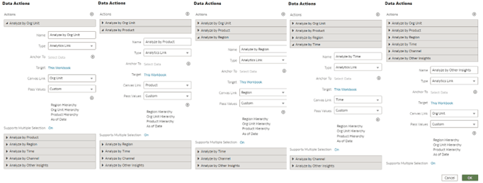

Figure 9-87 Data Action Configuration in Product canvas
From every chart available in Product you can select a value, and then navigate to the Org Unit, Region and Other Insights canvas.

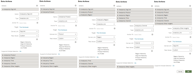

Figure 9-88 Data Action Configuration in Region canvas
From every chart available in Region, you can select a value, and then navigate to the Org Unit, Product and Other Insights canvas.
In order to do so, with a right click on the chart selection, the data action option (Analyze) will appear for you to be able to pass on the data filters to the canvas that you select.

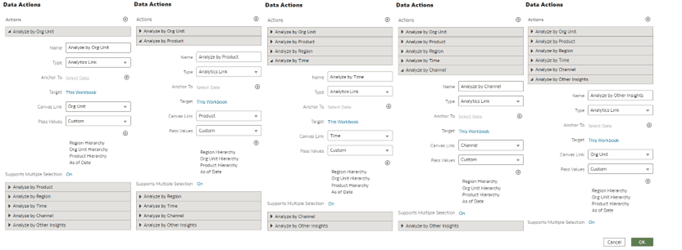

Figure 9-89 Data Action Configuration in Time canvas
From every chart available in Other Insights, you can select a value, and then navigate to the Org Unit, Product and Region canvas.

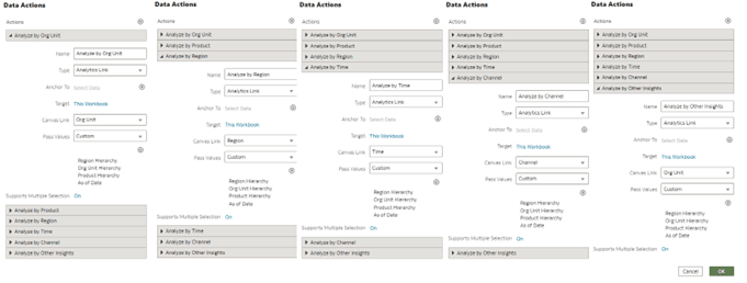

Figure 9-90 Data Action Configuration in Channel canvas
From every chart available in Region, you can select a value, and then navigate to the Org Unit, Product, Region, Time and Other Insights canvas.
In order to do so, with a right-click on the chart selection, the data action option (Analyze) will appear for you to be able to pass on the data filters to the canvas that you select.

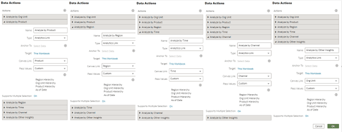

Figure 9-91 Data Action Configuration in Other Insights canvas
