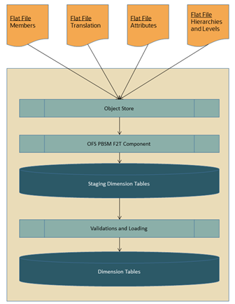

The following illustration depicts the process of Dimension Loading.
Figure 3-1 Dimension Loading Process
This illustration depicts the process flow of Dimension Loading process.
