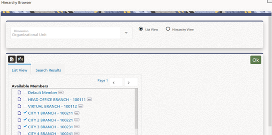

                     The Hierarchy Browser defaults to the List View that contains the list of all leaf members for the Key Leaf dimension you have chosen. You may scroll up and down to find the leaf member or leaf member you want. You may also search for a dimension member's name (short description) using the Search action button. Search has been revised as an inline search that implicitly comes with wildcard search. This functionality allows you to search a Dimension Member by its ID or Name. Once you have selected the Key Leaf values you want, click OK. Figure 2-4 Organizational Unit Hierarchy Browser

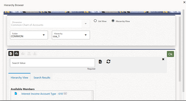

- You may also define Key Leaf values to be rollup members within a hierarchy. To
                select hierarchy rollup point members, click on Hierarchy
                    View near the top right of the browser window and then search for
                the hierarchy you wish to use. After the browser window displays your chosen
                hierarchy, navigate into the hierarchy until you have found the rollup points you
                want. Select the value or values you want and click OK.
                     Figure 2-5 Hierarchy Selection screen
- After you have clicked OK within the Hierarchy Browser window, that window closes
                and you are directed back to the Static Table Driver Definition tab. If you open the
                Hierarchy Browser of dimension, it shows the members as checked, which were already
                selected while defining a key leaf.

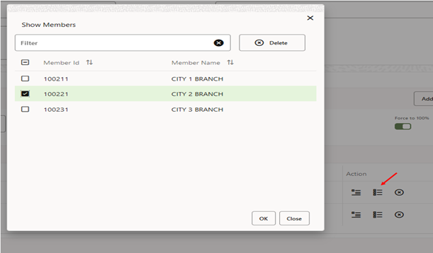

- If you want to view the members selected for a Key Leaf Dimension, you can click on
                the second icon in the Action column that appears adjacent to your Key Leaf
                Dimension. This feature also gives you the facility to delete any selected member
                without going through the Hierarchy Browser way.
                     Figure 2-6 Members Browser
When you select hierarchy, rollup points, all of the members, you select must come from the same level within the underlying hierarchy. Hierarchy Filters, which may include leaves and rollup nodes from different levels within a hierarchy, are not supported in Static Table Driver rules.Use Target Leaves only in Allocations that distribute to the Management Ledger.
