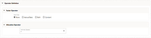

    Figure 5-16 Allocation Specification - Operator Process Tab
    The Operator process tab allows you to specify how Source data and Driver data interacts to create results.
  • Operator Process Tab for All Other Rule Types: For all other Rule Types, the Operator Process Tab offers both a Factor Operator and an Allocation Operator. The Allocation Operator links the Allocation Rule's Source Data with its Driver data. The Factor Operators may be interposed between the Source and Driver.
