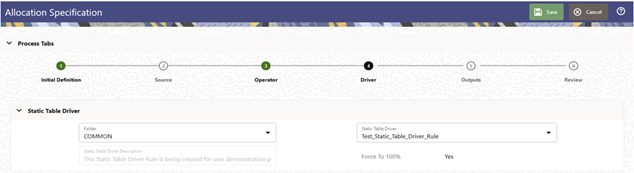

Next, build a new Static Driver Table allocation rule. In the Driver tab, select the Static Table Driver you just built.
Figure 5-72 Allocation Specification Edit screen - Driver tab

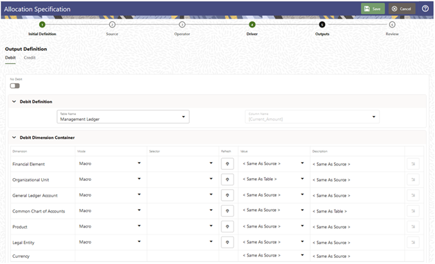

In your allocation Output Debit, specify < Same as Table > for the Organizational Unit dimension and specify < Same as Source > for every other dimension.
Figure 5-73 Allocation Specification Edit screen - Outputs tab
