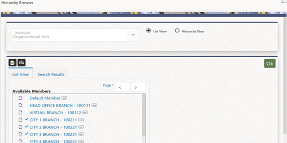

- Once a Key Leaf dimension is added, click the first icon in the
Action column to invoke the Hierarchy
Browser that appear adjacent to your Key Leaf Dimension.
The Hierarchy Browser defaults to the List View that contains the list of all leaf members for the Key Leaf dimension you have chosen. You may scroll up and down to find the leaf member or leaf member you want. You may also search for a dimension member's name (short description) using the Search action button. Search has been revised as an inline search that implicitly comes with wildcard search. This functionality allows you to search a Dimension Member by its ID or Name. Once you have selected the Key Leaf values you want, click OK.
Figure 5-67 Organizational Unit Hierarchy Browser

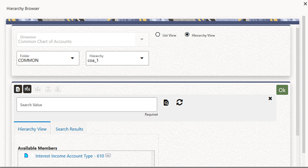

- You may also define Key Leaf values to be rollup members within a hierarchy. To
select hierarchy rollup point members, click on Hierarchy
View near the top right of the browser window and then search for
the hierarchy you wish to use. After the browser window displays your chosen
hierarchy, navigate into the hierarchy until you have found the rollup points you
want. Select the value or values you want and click OK.
Figure 5-68 Hierarchy Selection screen

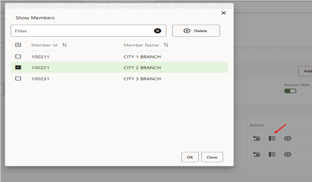

- If you want to view the members selected for a Key Leaf Dimension, you can click on
the second icon in the Action column that appears adjacent to your Key Leaf
Dimension. This feature also gives you the facility to delete any selected member
without going through the Hierarchy Browser way.
Figure 5-69 Members Browser
