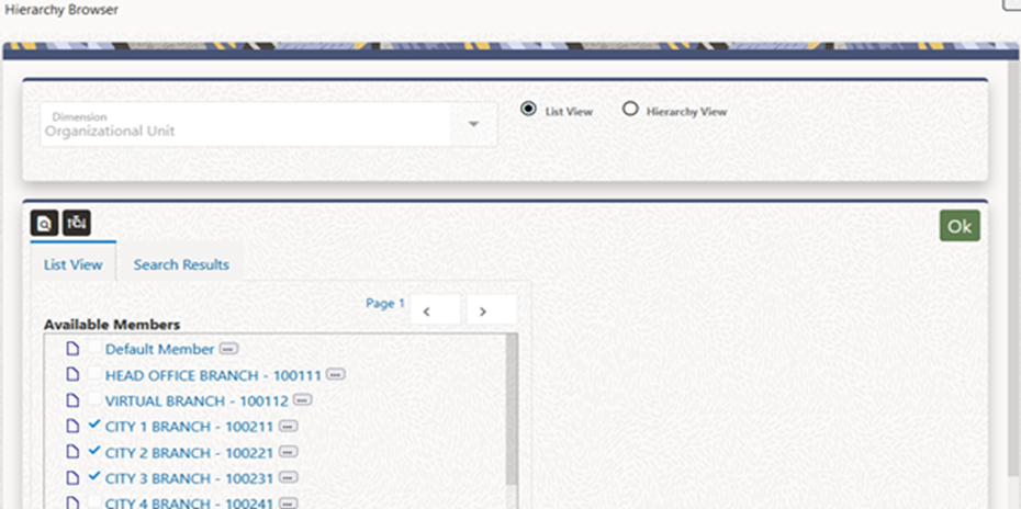

    The Hierarchy Browser defaults to the List View that contains the list of all leaf members for the Key Leaf dimension you have chosen. You may scroll up and down to find the leaf member or leaf member you want. You may also search for a dimension member's name (short description) using the Search action button. Search has been revised as an inline search that implicitly comes with wildcard search. This functionality allows you to search a Dimension Member by its ID or Name. Once you have selected the Key Leaf values you want, click OK.
    Figure 5-68 Organizational Unit Hierarchy Browser

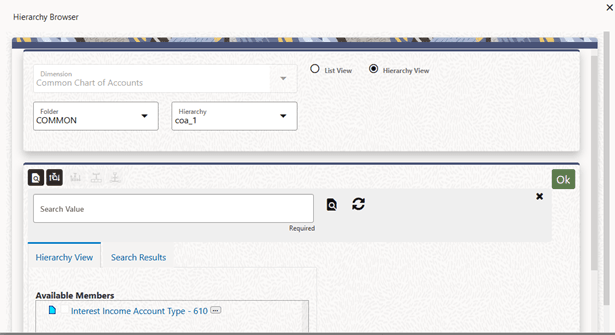

    To select hierarchy rollup point members, click Hierarchy near the top of the browser window and then search for the hierarchy you wish to use. After the browser window displays your chosen hierarchy navigate into the hierarchy until you have found the rollup points you want.
  5. You may also define Key Leaf values to be rollup members within a hierarchy. To select hierarchy rollup point members, click on Hierarchy View near the top right of the browser window and then search for the hierarchy you wish to use. After the browser window displays your chosen hierarchy, navigate into the hierarchy until you have found the rollup points you want. Select the value or values you want and click OK.
    Figure 5-69 Hierarchy Selection screen

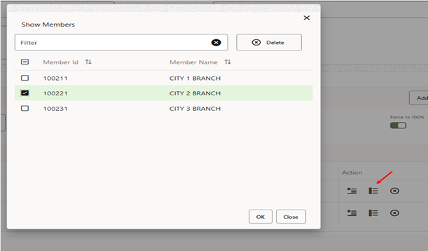

  7. If you want to view the members selected for a Key Leaf Dimension, you can click on the second icon in the Action column that appears adjacent to your Key Leaf Dimension. This feature also gives you the facility to delete any selected member without going through the Hierarchy Browser way.
    Figure 5-70 Members Browser
    The Member Browser screen displays the Member ID and Member Name. This screen allows you to select a Member.
