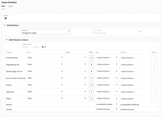

5.3.1.1.6 Outputs Process Tab
The Outputs Process Tab allows you to specify where the outputs of an Allocation Rule are written. When the output generates to the Management Ledger Table, the allocation engine creates Management Ledger debits and/or credits. When the output generates to Instrument or Transaction Summary Tables, the Allocation Engine updates Target Columns.
Figure 5-29 Allocation Specification – Output Process Tab
