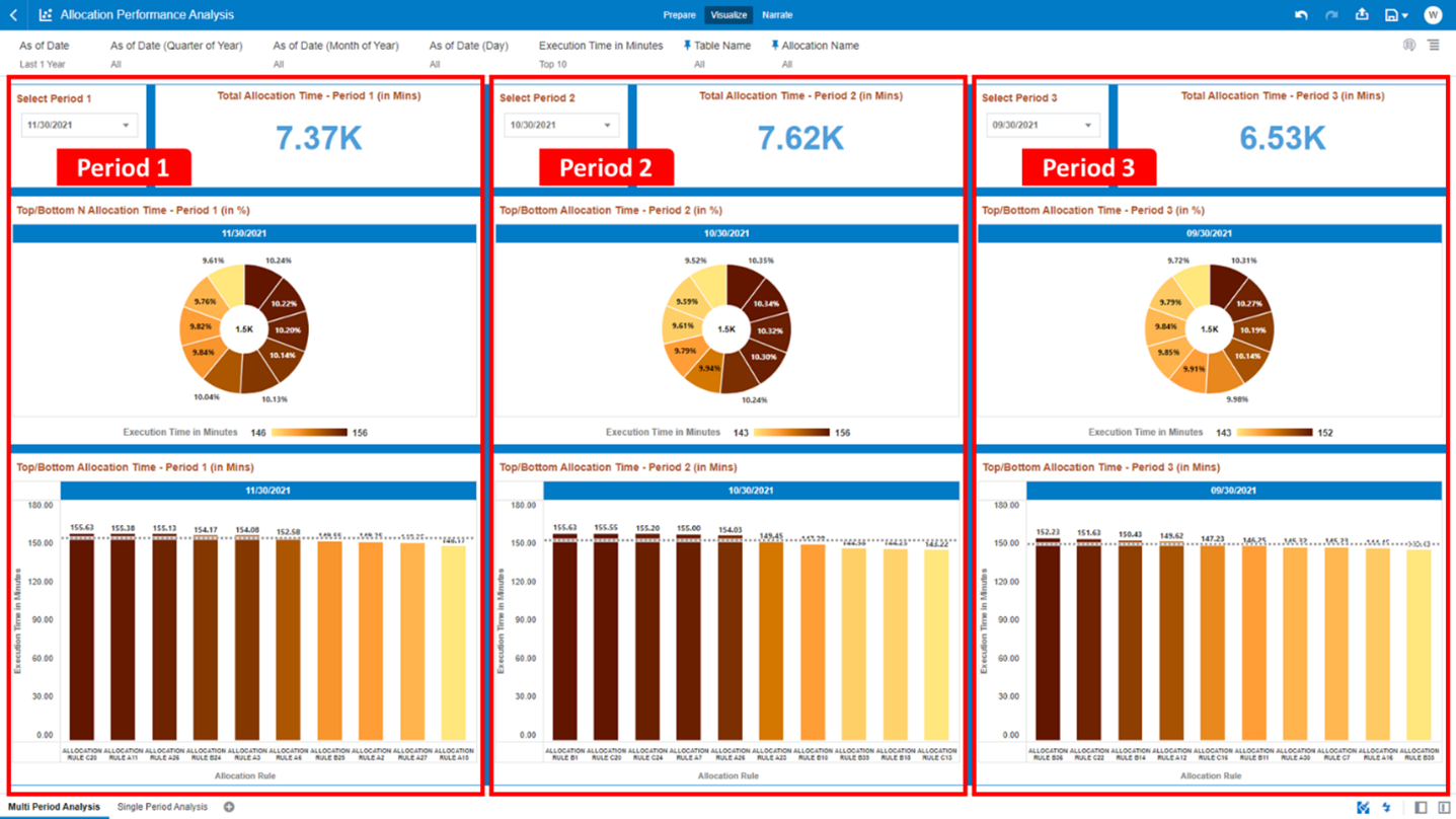

The result of the three previous selection steps is shown in the following screenshot. You can compare the multiple periods and analyze the performances across them.
The report displays the underlying data according to the following charts’ logic and for the three sections Period 1, Period 2, and Period 3 (the charts description will reference only the “Period 1” as for the other periods the content will be functionally the same):
- Select Period 1 (2 or 3)
The As-of-Date selected for the Period that you want to analyze.
- Total Allocation Time - Period 1 (2 or 3) (in Mins) – (Tile Chart)
The total time spent in minutes for all the Allocation Rules executed during the selected period.
- • Top/Bottom N Allocation Time - Period 1 (2 or 3) (in %) – (Pie Chart)
The chart displays the N Allocation Rules, out of the Top/Bottom N selection (where N is related to the value used in the Report Prompts Filter selection on the “Execution Time in Minutes”; in the screenshot for example we have filtered “Top 10”), sorted by the Allocation Rule Percentage Value.
The Percentage Value, is calculated based on the “Execution Time in Minutes” spent for the Allocation Rule, out of the total time spent for the Top/Bottom N Allocation Rules selected.
In the following, we see, for instance, what is the Allocation Rule that needed more time to be executed and that is the one scoring a higher percentage value out of the total time spent within the Top/Bottom N selection.Figure 7-127 Top/Bottom N Allocation Time – Period 1 (in %)
The chart also displays the “Execution Time in Minutes” needed by the Top/Bottom N Allocation Rules (this value is visible at the center of the above pie chart screenshot and in this example is “1.5K” minutes).
- Top/Bottom Allocation Time - Period 1 (2 or 3) (in Mins) – (Bar Chart)
The chart displays the N Allocation Rules, out of the Top/Bottom N selection, sorted by the “Execution Time in Minutes” in descending order.
Figure 7-128 Allocation Performance Analysis – Multi Period Analysis
