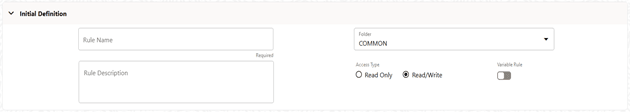

Initial Definition Pane
Specify the Allocation Rule Name and Description, select a Folder in which the Allocation Rule is to be stored, and specify whether you want the Allocation Rule to be Read/Write or Read Only (Access Type). Naming your Allocation Rule is required before it is saved. Default values for Folder and Access Type are stored in Application Preferences for Profitability Management Cloud Service. It also hosts the toggle button of Variable Rule.
Figure 6-13 Initial Definition Pane
This screen allows you to define new allocation specification rule by entering rule name, description, folder, access type, and variable rule.

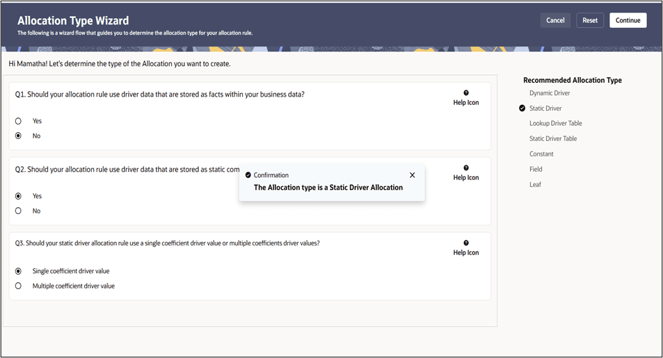

Allocation Type Wizard
The Allocation Type Wizard can be invoked from the ‘Wizard’ button placed adjacent to the Allocation Type dropdown field. The following window pops up when the wizard is invoked.
Figure 6-16 Allocation Type Wizard
This is a questionnaire based wizard that can guide users to derive the correct allocation type of an allocation rule based on the answers provided to the questions asked. This wizard guided path is an optional feature. Users can ignore the ‘Wizard’ button and select the allocation type from the allocation type dropdown provided.
This wizard acts a guided path primarily for inexperienced and new users to the Profitability Management Cloud Service to derive the correct allocation type.
As the responses are provided to the questions asked through the questionnaire, the wizard wisely takes the user to the next logical question to derive the correct allocation type. The following is a sample example of such question answer flow.

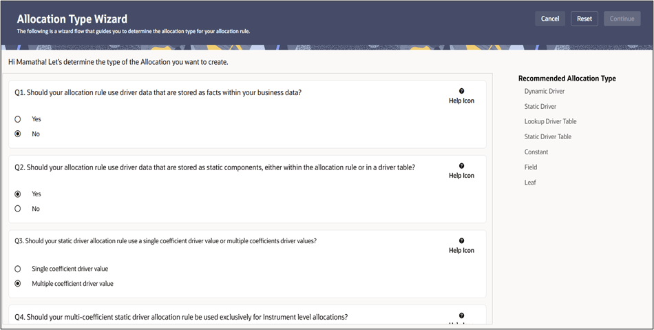

Figure 6-17 Allocation Type Wizard
The user can reset at any point to reset the responses to the questions and start answering to the questionnaire from the beginning again.
As soon as the wizard can conclude the allocation type, the wizard displays the derived allocation type with a confirmation message. The user can return to the Allocation Rule Detail page by clicking on the Continue button.
