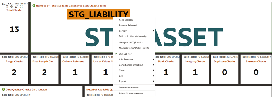

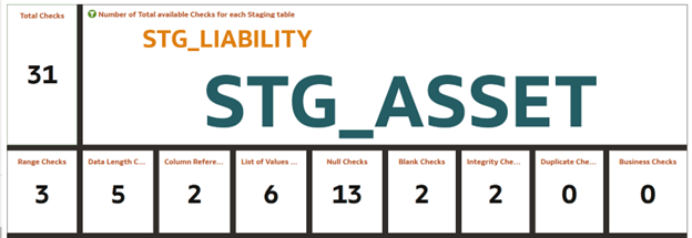

DQ Check Platform Availability
You can use the following filters:
  • DQ Rule Name: Rules created in the Application
  • Base Table: Base tables used in the rules
  • Severity Values: Error, Warning, Info
Total Checks: Number of Checks created in the Application.
Number of Total available checks for each Staging table: Gives the information regarding number of checks based on the various staging tables.
The following reports gives the information regarding the number of various checks created.
  • Range Checks: Total number of Range checks defined in the system.
  • Data Length Checks: Total number of Data Length checks defined in the system.
  • Column Reference Checks: Total number of Column Reference checks defined in the system.
  • List of Values Checks: Total number of List of values check defined in the system.
  • Null Checks: Total number of Null checks defined in the system.
  • Blank Checks: Total number of Blank checks defined in the system.
  • Integrity Checks: Total number of Integrity checks defined in the system.
  • Duplicate Checks: Total number of Duplicate checks defined in the system.
  • Business Checks: Total number of Business checks defined in the system.
Figure 9-78 Number of Total available Checks for each Staging table
Data Quality Checks Distribution gives the distribution of checks based on the base tables.
Detail of Available quality checks in the platform gives the percentage distribution according to severity category defined on different Staging tables.
Figure 9-79 Detail Quality Checks Distribution and Detail of Available Quality Checks in the Platform

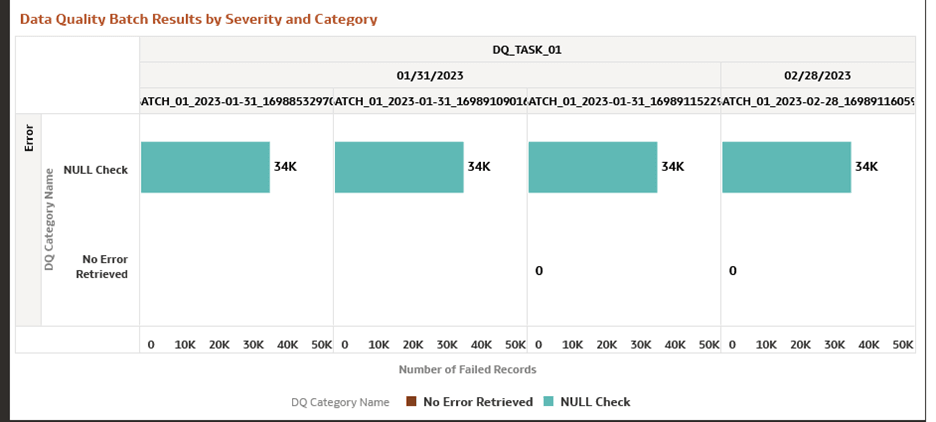

Results of Data Quality Batches by Severity and Category: This report provides details on the quantity of failed records across various batches, including the execution date and batch name according to Data Quality Category Name.
Figure 9-81 Data Quality Batch Results by Severity and Category

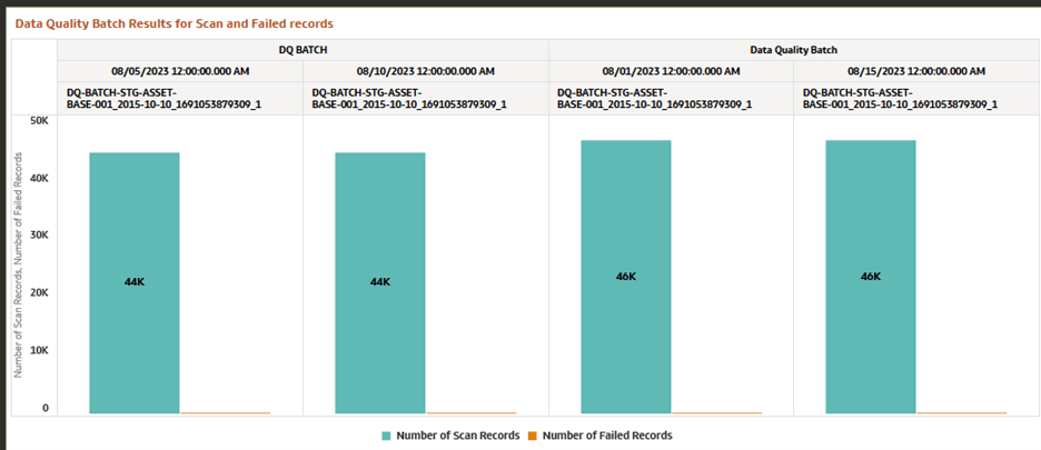

Results of Data Quality Batches for Scanned and Failed Records: This report presents a bar chart illustrating the total number of scanned records and total number of failed records, categorized by batch name and execution date.
Figure 9-83 Data Quality Batch Results for Scan and Failed Records

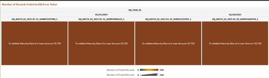

Number of Records Failed by DQ Error Value: This report shows the information regarding number of errors along with the Data Quality Check Description separated by batch names and execution dates.
Figure 9-86 Number of Records Failed by DQ Error Value

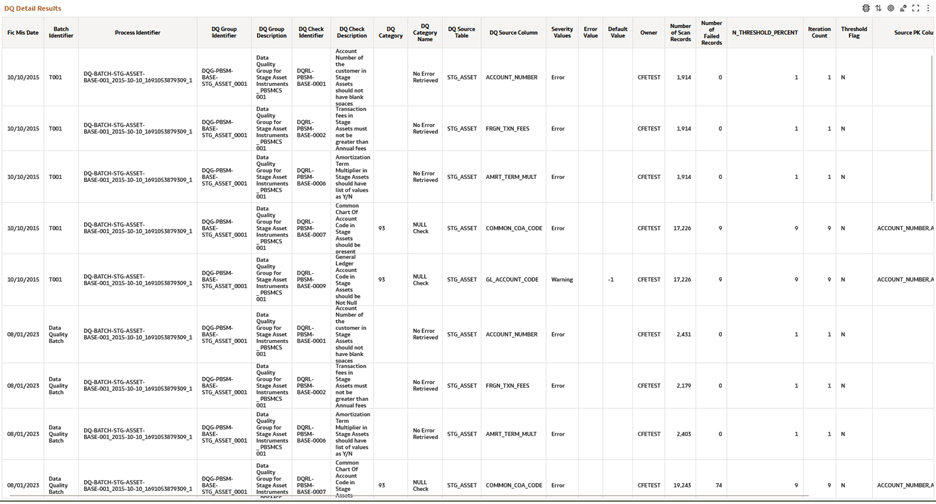

DQ Detail Results
This canvas gives the detailed information regarding the Data Quality Batch information.
Figure 9-87 DQ Detail Results
DQ Detail Results
