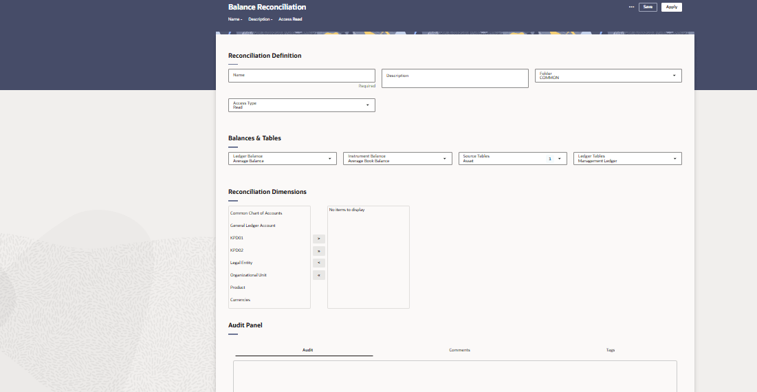

The Create Reconciliation screen allows you to define a new Reconciliation Definition.
To add a new Reconciliation Definition, click the Add button on the summary screen.
Figure 3-53 Create Reconciliation Definition Screen
Reconciliation Definition set up allows you to choose for which Instrument Table, across which Dimensions and on which Balance Type (Cur Book Bal or Cur Par Bal); you would like to perform reconciliation. For example, you can choose to reconcile against just GL Account ID and Currency or do reconciliation at much granular level by selecting the Org Unit, Legal Entity along with GL Account ID and Currency.
While selecting reconciliation key dimensions, you have the option to choose from activated placeholder dimensions as well along with seeded key dimensions.
Similarly, there is a seeded Management Ledger table, which is used by default for balance reconciliation against the selected portfolio of accounts. In the current user interface, only Management Ledger is available for selection in the Ledger Tables field.
Users can select the required additional ledger table during Balance Reconciliation setup and use it as part of the reconciliation process.
The Ledger Tables field displays Management Ledger via DME as the available ledger option.
