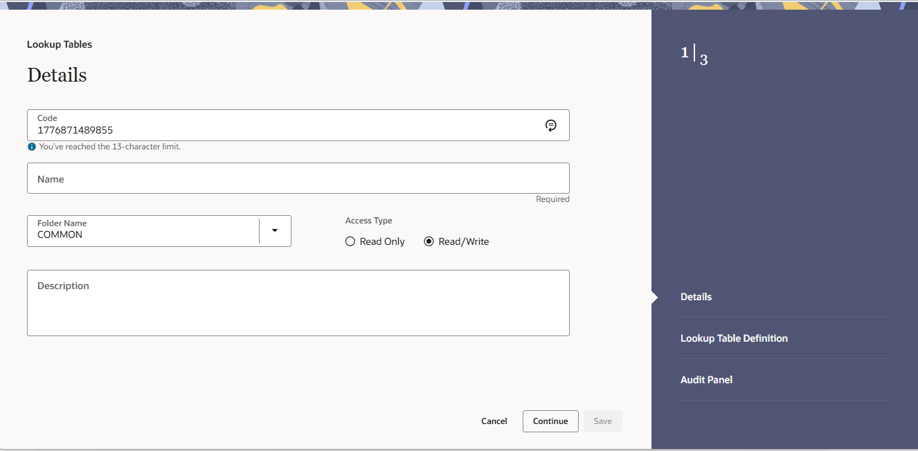

Specify the Lookup Table rule's Code, Name and Description, select a Folder in which the Lookup Table rule is to be stored, and specify whether you want the Lookup Table rule to be “Read/Write” or “Read Only” (Access Type). Naming your Lookup Table rule is required before you save it. The default values for Folder and Access Type are stored in User Preferences.
In the Code field, the code is auto-generated. You can also manually enter a numeric code. Only numerical values are allowed; special characters are not permitted.
Figure 6-72 Lookup Tables - Details tab

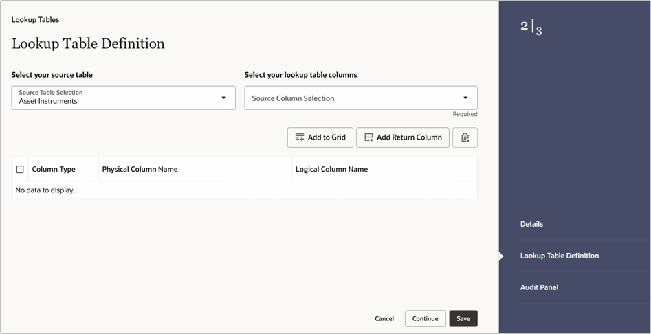

Lookup Table Definition
Select a Source table to create your Lookup Table. The source table list is limited to the instrument tables available under PBSMCS. The Source column dropdown lists all the columns available in the selected source table except the VARCHAR domain type columns.
Click on the ‘Add to Grid’ button to include the selected column into the Grid.
Figure 6-73 Lookup Tables – Lookup Table Definition tab

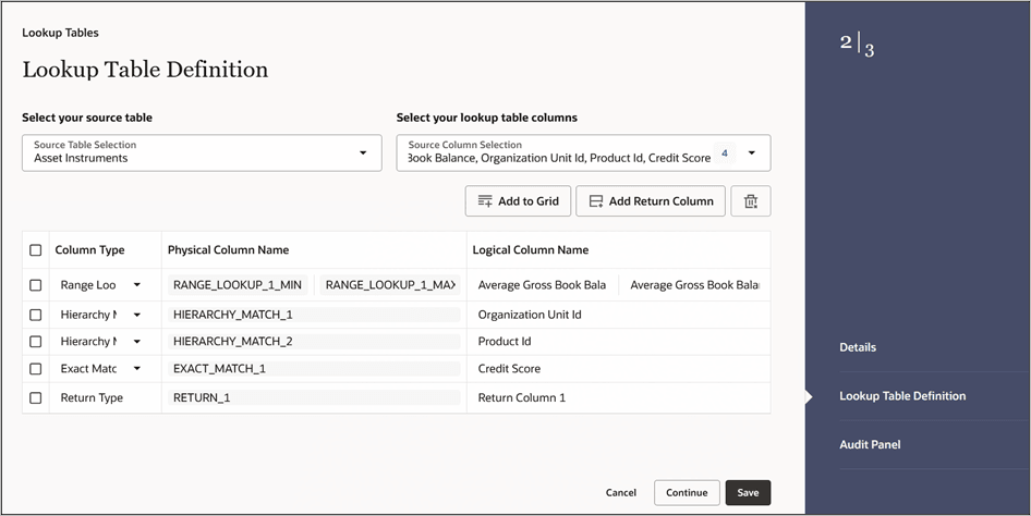

The Lookup Table Grid is essentially a table that displays the column type, the physical column name and the logical column name of the columns of the Lookup table. The grid is displayed as blank in New mode while it displays the lookup table columns in View and Edit mode. The logical names of the columns are editable for user input.
The grid is populated by the ‘Add to Grid’ button available in the earlier pane.
Users can add return columns with the ‘Add Return Coulmn’ button while any added column in the grid can be removed with the ‘Delete’ button.
Once an instrument column has been added in the grid, the same column becomes un-selectable the next time the user wants to select and add to the grid.
Users can drag and change the order of the selected columns in the grid as per requirement and the physical database table will be created with the same order of the columns. Users can drag and drop columns by holding and releasing the mouse left click under the Logical Column Name column.
The Lookup Table rule supports three column types:
  • Range Lookup: for all instrument non-dimension columns.
  • Exact Match: for all instrument columns – both dimension and non-dimension.
  • Code Match: for VARCHAR code-type instrument columns, such as Product Codes, GL Account Codes, and Org Unit Codes. Performs a literal match on the code value.
  • Hierarchy - ID Match: for all instrument dimension columns.
  • Hierarchy - Code Match: for all instrument dimension columns, identified by the alphanumeric member code. This allows for matching dimension members on the code values.
Figure 6-74 Lookup Table Definition with the Grid filled in a New mode
